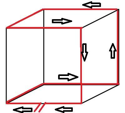

Find the magnetic field at a point p in the center of the cube with side length 2b.
Biot-Savart Law
I attempted using the biot-savart law, but my answer contradicts what someone told us as a hint. Supposedly the magnitude of the field at the bottom-front edge of the cube is B = U_o*I*sqrt(2/3)/(4*pi*b).
I get U_o*I*-(Ux+Uz)/(4*pi*b) as the B-field experienced at p from the bottom-front edge. What might I be doing wrong?
I have dl = -dx*Uy
r(hat) = (-Ux+Uz)/sqrt(2)
integrated from -b to b for any given side
Any ideas as to where this difference is coming from? I would imagine by symmetry that sides with opposing currents will cancel out the B-fields at P (i.e. bottom front and back).

I'd start out with the right hand rule, and draw in some vectors at the center to see where each segment directs the field
Ok, that helps me visualize it a bit better. I'm still concerned about the magnitude of the side I first calculated though. I cannot see how they can get sqrt(2/3).
Using the RHR, my vectors match up for the first three sides on the base of the cube. However, when I calculate the vector for the side when the current travels upward, my vector doesn't make sense. I don't know whether to approach it as Uz*dz X (Ux-Uy) as my resultant vector is (Ux+Uy) which seems to make sense by the RHR but isn't obvious to me at this point. I also have the same concern with approaching from the top of the cube. For example, the top back side gives me (Ux+Uz) when I approach it via a right triangle of vectors, yet the RHR leads me to believe it is actually (Ux+Uz). Could you please clarify for me which of these is the correct approach?
In any side, I obtain the coefficient Uo*I/(4*pi*b) which makes sense due to symmetry. I am just mainly concerned about the advice I received prior to starting this problem, as I cannot see how they could obtain such a value.
EDIT: On second thought, would the vector for the bottom front side actually be in the (Ux-Uz) direction? The RHR leads me to believe so. I think I may have been trying to visualize vectors for the electric field instead.
Thanks
What corner are you setting as the coordinate origin?
Think about RHR and vector using pairs of parallel wires---that way your resultant vectors are in the cartesian directions (i.e. perpendicular to the faces of the cube).
And the root 2/3 surely comes from the geometry, namely the 1/root(3) from the pythagorean theorem.
I've started using a coordinate system based with the origin at the left-front corner.
So with the biot-savart law with the bottom front I get:
dl = -Uy*dy
r(hat) = (-sqrt(2)*b*Ux-b*Uz)/(sqrt(3)*b)
r = (sqrt(3)*b)
so then for dl x r(hat) I end up with: ((-sqrt(2)*b*Uz + b*Ux)/(sqrt(3)*b)*dy
When I integrate from y=0 to y=2b I end up with:
B = (Uo*I/(6*pi))*(-sqrt(2)*Uz+Ux)/(sqrt(3)*b) .
This still doesn't match up with what I was told. Where am I going wrong? I can't think of a sensible way to show that the radius changes as it moves along the length of the wire.
