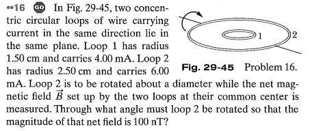

In Fig. 29-45, two concentric circular loops of wire carrying current in the same direction lie in the same plane. Loop 1 has radius 1.50 cm and carries 4.00 mA. Loop 2 has radius 2.50 cm and carries 6.00 mA. Loop 2 is to be rotated about a diameter while the net magnetic field B set up by the two loops at their common center is measured. Through what angle must loop 2 be rotated so that the magnitude of that net field is 100 nT?
B = (μ * Φ * i)/(4*π*r) magnetic field due to circular loop.
My attempt is the magnetic field due to loop1 and loop2 should get added
The magnetic field due to loop1 is
B1 =(μ0 * Φ * i)/(4*π*r) = (4*π*(2*π)*0.004) /(4 *π*0.015) = 1670nT.
I assumed this value should be less than 100nT. What is the reason?
The other question is "Loop 2 is to be rotated about a diameter?" Even if i rotate by any angle Φ will always be 2π as long as it is complete circle. Am I correct? Please advise.
The magnetic fields are vector quantities. When you rotate loop 2, what happens to the direction of B2?

Using the formula for the magnetic field at the center of a circular loop (see http://hyperphysics.phy-astr.gsu.edu/hbase/magnetic/curloo.html):
$$B = \frac{\mu_o I}{2 R}$$
I found ##B_1## to be 167.5 nT.
So, not sure what happened in your calculation. I haven't seen the form of equation you've used before (with the ##\Phi## term).
Likes Physicslearner500039 and TSny

I had to think about that, too. I believe the formula given in the first post is for finding B at the center of a circular arc that subtends an angle Φ. The full circular loop is a special case.
