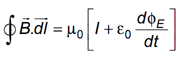

https://www.physicsforums.com/attachments/282201
Are we using this equation above to explain this question? The magnetic field is definitely in sinusoidal form but how does it proportional to the frequency of the source?

There will be electromagnetic waves from the capacitor whose voltage varies sinusoidal but they won't be plane waves like those equations you post at #3.
To find the form of waves assume that the electric field between the plates of the capacitor varies only with time but not with space, so it has the formula $$E=\frac{V}{l}=\frac{V_0}{l}\sin\omega t$$ where ##l## the distance between the capacitor's plates. Then use Ampere-Maxwell law to find the magnetic field generated by such an electric field. You can assume that the magnetic field lines will be concentric circles with their plane parallel to the plane of the capacitor's plates.

No this isn't exactly what i had in mind. What I had in mind is to apply Ampere-Maxwell law to calculate B for the E as given in post #4.

I think:
B * 2πr = μ0*ε0*dE/dt*πr^2
B = μ0*ε0*[v/l * cos(wt)] /2

Your first equation (above) looks correct. You're getting really close! But you don't need to assume the plates are circular - you could replace ##\pi r^2## with A (area).
(I'll ignore your second equation as it's incorrect - you haven't differentiated properly. Also you have introduced (I think) the max. voltage and the plate separation, which are unnecessary; stick with ##E_0##.)
Using ##E = E_0 \sin( \omega t)##, differentiate (correctly!) to find dE/dt. Put this into your first equation. Now you can get an equation for B. Look at this and see if you can answer the original question based on this equation.

B*2πr = μ0 * ε0* (E0*ω*cos(ωt))
So, this equation tells the magnetic field is sinusoidal and its amplitude (E0*ω) is proportional to the frequency of the source.
The amplitude of the B-field is not "E_0*ω".
If you want the amplitude (##B_0##) rearrange your formula into the form:
B = (expression)cos(ωt)
Then (expression) is ##B_0##.
However, you are correct in saying "amplitude ... is proportional to the frequency of the source". So this answers the original (Post #1) question!
