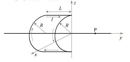

Picture of the problem:
I first need to calculate the magnetic field in point P caused by the piece of wire at z = R (so the top wire parallel to the y-axis).
[/B]
Biot-Savart law for magnetic fields:
##\vec {dB} = \frac {μ0*I} {4*π} * \frac {\vec {dl} ×\vec {r}} {r^3}##
[/B]
Here is what I did:
##\vec {dl} = dy * \vec {ey}## (where ey is the unit vector in the y direction)
##\vec r = (P - y)* \vec {ey} - R * \vec {ez}##
then:
##\vec {dl} ×\vec r = -R*dy*\vec {ex}##
so now I can write:
##\vec {dB} = - \frac {μ0*I*R} {4*π} *\frac {1} {(P - y)^2 + R^2)^{3/2}} * dy * \vec {ex}##
Now I can integrate this using the substitution ##u = P-y## and ##du = -dy##, and then integrate from ##-L## to ##0##, which gives me an expression for the magnetic field:
##\vec B =\frac {μ0*I} {4*π*R} *(\frac {P} {\sqrt {P^2+R^2}} -\frac {P+L} {\sqrt {(P+L)^2+R^2}}) * \vec {ex}##
Now this answer is almost correct except there should be a minus in front. However my minus disappeared when I used the substitution ##du = -dy##. Does anyone know where I went wrong?

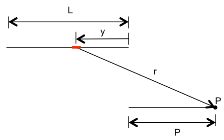

Yes, you're right. I think you put one minus sign too many with dy and the limits of integration. If you use the the right hand rule and the diagram below, you get
##\vec {dB} = - \frac {μ_0*I*R} {4*π} *\frac {1} {[(P + y)^2 + R^2]^{3/2}} * dy * \hat {x}##
Note the positive sign in the denominator. Also note that the limits of integration should be from zero to L, not negative L because the smallest value for the y-component of ##\vec{r}## is P and the largest value is P + L.

But shouldn't ##r = \sqrt {(P-y)^2+P}##? Since y is always negative in this case so the y component of ##\vec r = P-y##
I think your problem is with the back substitution from ##u## to ##y##.
You have the indefinite integral (after cancellation of the two negative signs)
##\vec B = \frac {μ_0I} {4πR} \int \frac {du} {(u^2+R^2)^{3/2}} \hat {x} = \frac{u}{R^2\sqrt{R^2+u^2}}##
Since ##u=P-y##, when ##y=0##, ##u = P## and when ##y=-L##, ##u=P+L##. These are the lower and upper limits that you should put back in the indefinite integral for ##u##.

Ignore the unit vector and its direction. The key things are the integrand, f(q) dq and the limits of integration. Note that I used q, a dummy variable of integration that eventually disappears when you evaluate the integral. You should always bear in mind that when you integrate, the "something" in d(something} can be any symbol. I think your confusion arises because you are treating y as both a dummy variable of integration and a Cartesian coordinate. In post #6 I have y increasing to the left. Strictly speaking, I should have called it something else, say q, because y should be reserved for the Cartesian coordinate that increases to the right.
Look at the drawing you made when you worked on this problem. Call the distance along the y-axis of element ##d \vec{l}## q, set up the definite integral and see where it takes you.
