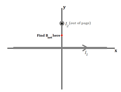

Required the magnetic field on the y-axis let us say point P.
The magnetic field due to the x-axis wire is out of the paper at P with the values as R=2.0m, i =30A.
B1 = (μ0*i)/(2*π*r) = (4*π*(10^-7)* 30)/(2*π*2) = 3uT,
For the Z axis wire the magnetic field is again into the paper at P with the values as R=2.0m, i = 40A
B2 = (μ0*i)/(2*π*r) = (4*π*(10^-7)* 40)/(2*π*2) = 4uT. The resultant is 1uT. The answer does not seem to match it is 5uT. Please advise.
The two fields are not parallel to each other.
Really?
Really?
Yes it is coming out of the paper.

How did you conclude this?
(I assume the paper is in the xy-plane, i.e. perpendicular to the z-axis at z = 0.)
Likes Physicslearner500039
Yes
Yes
Good. From the diagram, what is the direction of the magnetic field at the red dot due to current ##I_2##?
Yes i think it is in positive X direction. Am i correct?
Yes :oldsmile:
