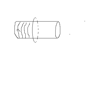

A coil of wire with N turns is placed around the a long solenoid with n turns per unit length carrying a current I as shown below,
A)If a current I flows through the solenoid, derive an expression for the magnetic flux through the coil and explain why the size and shape of the coil is not important.
B)If the current in the solenoid is varied with time as given by the expression ##I(t) = I_o + I_1t + I_2t^2## and the resistance of the coil is R, derive an expression for the induced current in the external coil of wire.
Ampere's Law
Magnetic Flux
The magnetic field inside the solenoid is a constant ##\mu n I##. So the magnetic flux through the solenoid is ##\mu n I (\pi r^2).## Since we want the magnetic flux through the coil only this becomes ##\mu N I (\pi r^2)##(1).
However, the magnetic field caused by the current in the solenoid loop will induce a current inthe coil in the opposite direction to that of the loop in the solenoid.
By Ampere's Law, take a circle of radius smaller than that of the coil. The enclosed current is ## N I## and so ##\int B \cdot ds = \mu N I \Rightarrow B = \mu N I/(2 \pi R), R## the radius of the Amperian loop.
The coil (I assume) is perfectly symmetrical around the solenoid. So all B field contributions from the wire cancel. So B flux is given by (1). Is it correct?
If we take an Amperian loop to coincide with the radius of the solenoid, then no matter what shape the coil is, the enclosed current will always be the same. (But I don't see how this implies the B field would be same though). When they talk about size, do they mean a coil with a radius greater than that of solenoid?
2) Induced emf ,##E = -\dot{\phi} = -\mu N r^2 \pi [I_1 + 2 I_2 t],## so ##I_{ind} = E/R = -\mu N r^2 \pi [I_1 + 2I_2 t]/R ##. (minus because current in opp direction)
Only if I is changing (or your coil is superconducting).
For (A), the coil does not change the magnetic flux.
A radius, or any similar parameter (side length for a rectangle, ...).
I agree with your solutions.
Does this mean that if the current in the solenoid loop was constant, then there would be no induced current in the coil?
Because it does not have an induced current and thus no changing magnetic field and so does not contribute anything to the flux?
I'd just like to check a couple of things:
-There is no changing current in (A) and so no induced current in the coil => no B field from the wire. So the shape of the coil does not matter because by Ampere's Law, I can always take a circle coinciding with the radius of the solenoid. The enclosed current is NI => the flux is μNIπr2. The size of the coil can range from r to ∞ since the only contribution of the flux is from inside the solenoid.
-Now say there was an induced current in the coil. The above does not hold because the magnetic field (generated by coil)will depend on the shape of the coil. Even though I can still take my Amperian loop to be of radius r, different shapes of the coil will result in differing magnetic fields on the surface of the Amperian loop and so affect B.ds
Thanks for the check.
You can use your answer in (B) to see it yourself ;).
Because it does not have an induced current and thus no [highlight][][/highlight] magnetic field and so does not contribute anything to the flux?
This (I removed one word).
Exactly at the solenoid? Why?
You need a different shape to get an enclosed current.
Right
Right.
I suppose it doesn't have to be. Maybe a radius just a bit bigger than the radius of the solenoid.
That would be a cylinder of radius r (r as noted above, just a bit bigger than the radius of solenoid) and height h, h being such that all N turns are contained.
