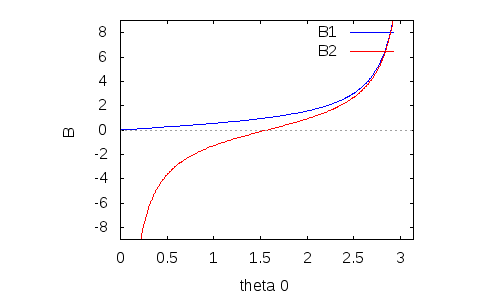

I have tried to solve the same problem as in the first post with Ampere's law, with some results which are probably wrong. Feynman considered an example which I don't think is very relevant here. He considered a radial distribution of both currents and electric fields, so that the current j is canceled at any point by the displacement current 1/c^2 dE/dt (in SI units).
Now I think the 2 currents can be separated so that there is only one of them on the spherical surface that is considered. The cleanest way I can think of is the following: the spherical capacitor is charged and is not leaking; then the plates are pushed one toward the other and the surfaces are modified continuously so that they remain spherical with the same initial center. Then the plate movement would give an electrical current for each plate, while the field between plates would change in time, thus giving a displacement current. The 2 currents would not appear in the same region. A spherical surface between the plates would see only the displacement current.
Then how could one prove that B=0? This would be true because the spherical symmetry means B is radial and since div B = 0, B must be 0.
Now about my results, I considered a capacitor in the form of a spherical cap (plates extend for 0<θ<θ0, so they are not full spheres). The two plates have very close radii, so that the fringe effect can be neglected (but can it?). A took a surface S between the plates (say in the middle) and applied Ampere's Law to determine the magnetic field on its contour (loop L). I considered B to be circular here due to the figure's symmetry wrt. the vertical axis (also think how the magnetic field produced by each jd looks like - it should be along L). The capacitor's plates are not represented in the figure.
Now as the plates approach but keep their spherical shape, the electric field between varies as ∂E/∂t. Then by Ampere-Maxwell Law on L:
LB⋅dl = μ0 ∫∫S (j + jd)⋅dS,
where j is the current density j=0 and jd = 1/c2 ∂E/∂t is the displacement current density, the only one counting on S. Now if jd is constant, this can be integrated easily. The surface element is dS = R dθ r dφ = R2 sin(θ) dθ dφ, where r = R sin(θ) and θ goes from 0 to θ0 and φ from 0 to 2π. It follows:
2πr B = μ0 jd S,
2πR sin(θ0) B = μ0 jd 2πR2 (1-cos(θ0))
and thus:
B(θ0) = μ0 jd R (1-cos(θ0))/sin(θ0) = B1.
Now extend this to θ0=π and it follows that B=something/0=∞, where it should be 0 I think.
Another approach would be to take a full spherical capacitor, so that loop L sees 2 displacement currents (one above, one below L). The two currents produce opposing magnetic fields on L so that:
B(θ0) = μ0 jd R [ (1-cos(θ0))/sin(θ0) - (1-cos(π-θ0))/sin(π-θ0) ],
B(θ0) = -2 μ0 jd R cos(θ0)/sin(θ0) = B2.
Now B=-∞ at θ0=0 and B=∞ at θ0=π and B=0 at θ0=π/2 (on the equator). Again B is not 0 everywhere. Instead B is along the sphere, such that div B=0, but it lacks spherical symmetry. Moving the vertical axis obliquely would change the direction of B at the same points, which cannot be.
Am I missing something? Does the fact that the last formula works well on the equator mean something? Maybe loop L has to be composed of 2 loops symmetrical wrt. to the equator and knotted on a line perpendicular to the equator so that B cancels on it.
