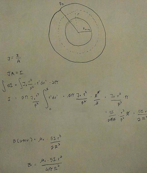

Just taking steps 1 at a time, I first drew a diagram then I found Jo in terms of I and R, and since it is a non uniform current I know that to find the current I use
J = I / A
substitute A for 2(pi)rdr, and then integrate and solve for Jo,
Am I correct as of this far?
Looks good to me. :smile:

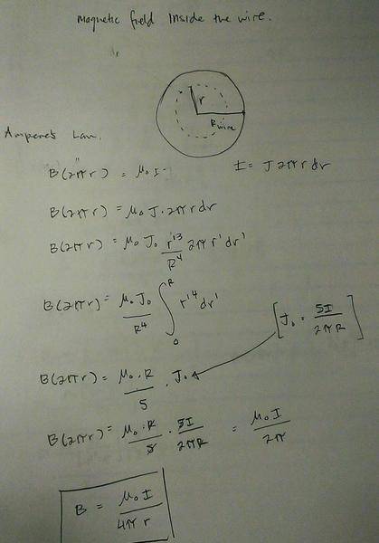

Awesome!, now this is what I did for the magnetic field inside the wire. Since there is s non uniform current I have to integrate the i.
You need a correction in your upper limit of integration. But you are close to setting it up correctly.
(Also, you might want to be more careful in writing your equations. It is not true, for example, that ##B (2 \pi r) = \mu_0 J\, 2 \pi r dr##. The right side needs to include the integration in order for the left side to equal the right side.)
Oh, my upper bound goes to little r. So that changes my value of
B(inside wire) = (mu-knot) * I / 4(pi) *R(wire)
No, this can't be right. The magnetic field inside the wire should depend on the distance r from the center of the wire. So, you should recheck your calculation.

Oh I see that I made some arithmetic error for part a)
What I got was
B = (mu-knot * I * (r^4)) / (2pi * (R^5))
What I got was
Yes, I think that's right.

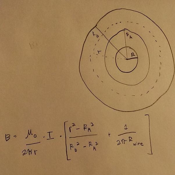

Awesome! Now for part c, using the same logic as before the total current in the wire would just be I, and so I just need to find the distribution of I within the cylinder, which was found above. But this is what I have so far,
Your first equation is correct if ##I_{cylinder}## is the part of the current in the cylinder that is enclosed in your dotted path and if ##I_{total}## is the total current in the cylinder. But remember, the total current in the cylinder is given to be ##I## (the same as in the wire).
In your second equation, did you include the current in the wire?
No I did not, I figured since the radius r is bigger than the wire, the current would've already been included in that I. To account for the current in the wire, do I just add in the current for the whole wire? Which is

Yes. Whenever you use Ampere's law [itex]\oint \vec{B} \cdot d\vec{s} = \mu_0I_{enclosed}[/itex], the current on the right hand side is the total current passing through the path of integration that you are using on the left side.
So my final answer for part C, since I am adding in the current of the wire my equation would be
Not quite. The very last term inside the brackets on the right is incorrect. Note how the first term in the brackets is dimensionless but the second term is not.
Backing up to ##B 2\pi r = \mu_0 I_{enclosed}##, how would you express ## I_{enclosed}##?

##I_{\rm enclosed} = I_{\rm cylinder} + I_{\rm whole wire}##. As stated in the problem, ##I_{\rm whole wire} = I##.
"Dimensionless" means that it is a pure number (all the units cancel out).
Oh..
So
I enclosed = I * [(r^2) - (Ra^2) / (Rb^2) - (Ra^2)] + 1
then
making my equation
B = Mu(knot) * I[enclosed] which was found above?
The +1 should be inside the bracket so that ##I## multiplies the +1.
Your expression for B is missing ##2\pi r##.
ah perfect, thank you.

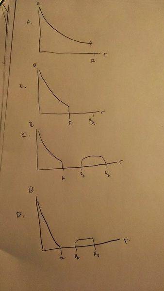

now for the graphs of each..
for part a ) the graph looks like it would be similar to an r^4 graph
b ) similar to an 1/r graph
c ) I am thinking this one would just be a r^2 / r or r? linear?
d ) would just also look like part b?

And I gave some more thought on my graphs and I believe they will look like this
I agree with your result for B outside the cylinder.
Your graph doesn't look correct. Inside the wire, B is proportional to r4. So, B should increase in this region.
It looks like your graph is showing B = 0 between the wire and the cylinder and also for outside the cylinder. But you know that isn't right.
so for part A, the graph should just look like an increasing function, something that looks similar to an ##r^4## graph?
and part b/c/d they just look like a decreasing exponential graph?
In the region between the wire and the cylinder and also in the region outside the cylinder (r>Rb) the field will just graph as a constant times 1/r (with different constants for the two regions). Inside the cylinder, B varies as A*r + C/r where A and C are constants.
To get the shape of the graph, you could let ##\frac{\mu_0I}{2\pi} = 1## and choose, say, ##R_{\rm wire} = 1##, ##R_a = 3## and ##R_b = 5##. Then plot some points in each region.
