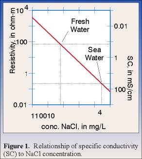

CWatters said:
Water could be considered a "conducting ether" just not a very good one.
Add some salt.
Likes Fibonacci Vonacci
Fibonacci Vonacci said:
1) Would current flow, and if so, what would the flow of electrons look like?
Let the battery be in the middle of a large saltwater pool. The flow will be symmetric about the axis of the battery? The flow will be most intense near the battery? Far from the battery the flow is small but not zero?

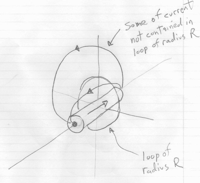

If the whole arrangement is perfectly symmetric the magnetic field would also have to be symmetric around the battery. But according to maxwell's equations - more specifically Ampère's circuital law - that field needs to be zero here since the total electric current enclosed by the magnetic loop is zero.
Only if the loop is very large will the total current through the area of the loop be zero.
Likes DrZoidberg
Likes DrZoidberg
DrZoidberg, could you expand on this a little bit please? I'm struggling to understanding why the field needs to be zero.
Look at Spinnor's drawing. The field strength approaches zero if the loop is very large. Otherwise it's non zero.
