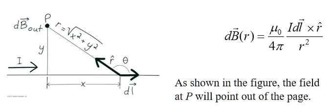

Find the magnetic field strength at point P (illustration below)
$$d\vec{B}(r) = \dfrac{\mu_0}{4\pi}\dfrac{Id\vec{l}\times\hat{r}}{r^2}$$

This is what I determined to be the magnetic force at P due to ##d\vec{I}##
$$B(r) = \int_{-\infty}^{+\infty} d\vec{B}(r)$$
$$B(r) =\int_{-\infty}^{+\infty} \dfrac{\mu_0}{4\pi}\dfrac{Iyd\vec{l}}{r^2}$$
$$B(r) =\dfrac{\mu_0}{4\pi}\dfrac{Iy\vec{l}}{r^2} \Big|_{-\infty}^{+\infty}$$
I don't think my solution is solvable, it just becomes positive infinity minus negative infinity

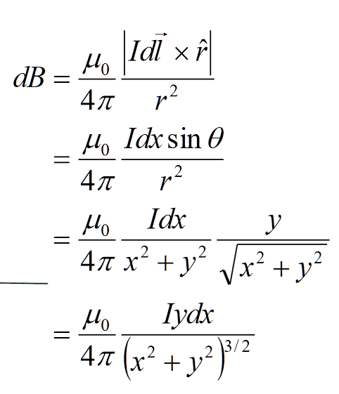

My professor had a different solution to ##d\vec{B}(r)##
I don't understand where ##r## went and how ##dx## was brought forth in the second step :oldconfused:

##r## didn't go anywhere. It is still there as ##\sqrt{x^2+y^2}.##
##d\vec l## is an element in the direction of the current. Its magnitude in this case is ##dx##.

I'm surprised you were able to understand all that before I fixed it.
I understand the second part of your comment, but where is ##\sqrt{x^2+y^2}## in the second step of my prof's solution?
Edit: I would have expected it to end up like ##d\vec{B}(r) = \dfrac{\mu_0}{4\pi} \dfrac{Idx\sin{\theta}}{r}##
@BuggyWungos, note that in the expression
##~~~~\dfrac {\mu_0}{4 \pi} \dfrac {I \vec {dl} \times \hat r}{r^2}##
##\hat r## is the unit vector in the r-direction; it’s magnitude is ##1##. Don't confuse it with ##\vec r##.

Thank you that's such a silly oversight, I even wrote it as r hat in latex and missed it lol
