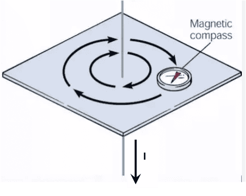

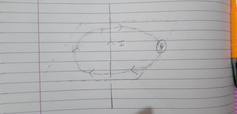

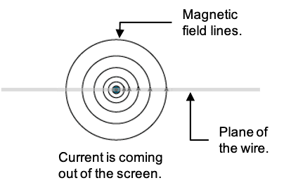

This is what I am trying to ask. The thing is that the needle is kept in the same plane as the wire but it is perpendicular to the plane of the magnetic field (shown in the diagram) so the magnetic field's direction is pointing outwards to the plane of the needle but how will we able to know that using a needle.
There is no complication of any specific XZ plane or such things. The things are simple and as follows:
  • There is a simple current-carrying wire.
  • There is an associated magnetic field with it in the plane perpendicular to the wire.
  • There is a magnetized needle kept in a plane perpendicular to the plane containing magnetic field lines. (The needle is essentially kept in the same plane as the wire with which we started)
The question is as follows:
  • Since the tangent to the magnetic field lines point perpendicularly in or out (out in the case of the image), in which direction would the magnetized needle point?
  • Thoughts in my mind: If the needle were to be in the same plane as the magnetic field (which is the plane perpendicular, not the same, as of the original wire.) it would have pointed in the direction of the magnetic field at that (or any) point, but how do we make the needle turn in a 3D space when it is only allowed to orient itself in a 2D space.
I hope the question is not as vague as before.

What are you talking about? Please post a picture and clearly explain what it is showing. It's OK to assume that your compass needle is mounted so that it could rotate at any angle.

So parallel to the wire? That will be a pretty unstable position, but if balanced perfectly the ferrous needle would not rotate. It would do something else instead -- can you say what and why?
berkeman said:
Sorry, what in the world are those?
The condensation of my doubt regarding them is the correctness of this explanation on this site.
The deflection should be towards the right if I ain't mistaken.
Yes yes. Maybe it will rest in any direction? like some kind of "SYSTEM ERROR" for the needle?

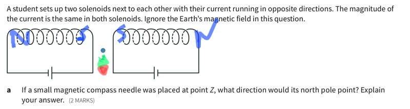

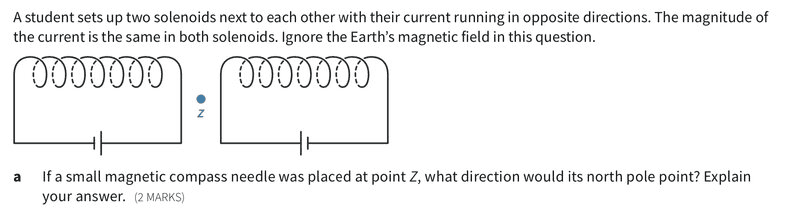

And sir (addressed to either (or both) of you @berkeman or(and) @kuruman) are the polarities or the solenoids correct? I had opened a thread previously but it generated a lot of messy replies because I wasn't able to understand a minor but vital thing which led to not properly arriving at the solution.
The original question was a bit suppressed by my vague doubts, i.e. the first and the original question in the thread below. Could you tell me which (the red or the green part) is the north pole of the magnetized needle?
According to me, green.
Also would you like to check if what I said in my last post on this thread is true? https://www.physicsforums.com/threa...le-between-two-solenoids.1059087/post-6987839

I think the needle will rotate downward, M is the magnetic dipole (the needle)

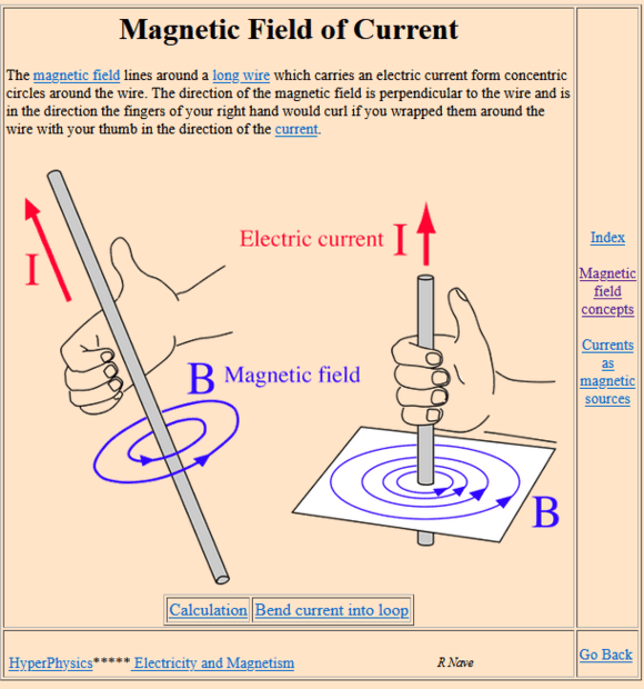

Here is a picture showing current in a long wire coming out of the screen. If you place a magnetic needle in the same plane as the wire (seen edge-on as a gray line), it will point up if it is on the right side of the wire and down if it is on the left side of the wire.
Your picture in post #1 should look like what I show below. Note that the current is reversed from yours because I couldn't find a picture on the web with the current up. Note that the needle is in a plane perpendicular to the wire.
Likes Darshit Sharma
Oh wow I totally misunderstood the question. But the idea is the same.

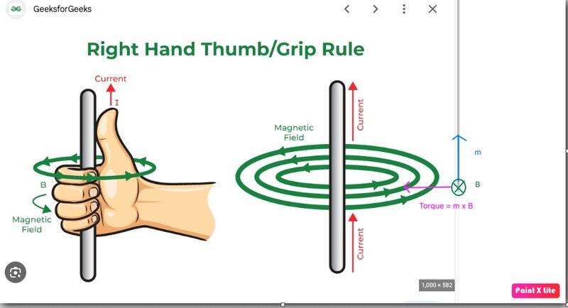

Alright here is a correction
##\vec{\tau} = \vec{m} \times \vec{B}##
##\vec{m}## is parallel to the wire (pointing up)
##\vec{B}## points into the page (That's what a X'd circle means)
Take the cross product and ##\vec{\tau}## points inward towards the wire. Meaning it spins into the page to align with the magnetic field.
There we go. I think this is all good now. Apologies to OP.
