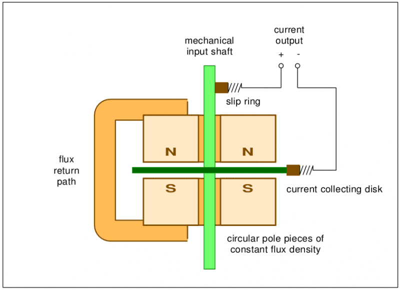

Circlotron
Suppose for a moment you had a circular copper disc placed concentrically in the air gap between the poles of an upper and a lower circular magnet, the outer faces of the upper lower magnet being connected by a pole piece so as to complete the magnetic circuit. The edge of the copper disc is connected to a first wire and the centre of the copper disc is connected to a second wire that passes through a hole in the centre of the upper magnet and the pole piece so both wires are unaffected by any airgap flux.
Basically a Faraday homopolar motor/generator setup. Nothing new so far.
If now the magnets and pole piece are held stationary and the disc is rotated about the axis of the assembly we will get a small emf induced across the radius of the disc because there is relative motion between the flux and the disc.
Conversely, if the disc is held stationary and the magnets and pole piece are rotated around the axis of the assembly, people more knowledgeable than I say that there will be no emf induced across the radius of the disc because the magnetic flux does not rotate axially with the magnet assembly so there is no relative motion between the flux and the disc.
Let's now switch from generator mode to motor mode and where the disc is held firm and the entire magnet assembly is free to rotate (within the limits of the pole piece going from the outer faces of the upper to lower magnet colliding with the wire connected to the disc edge).
If we now pass a current through the radius of the disc, the unmoveable disc will exhibit a torque in a certain direction and the magnet assembly may or may not exhibit a torque in the opposite direction. If the magnet assembly does exhibit a torque it will rotate until the pole piece hits the wire.
Here is where things get interesting. If the magnet assembly does in fact exhibit a torque and rotate a certain distance then it is capable of doing work. However, established thinking says that the rotating magnet assembly will NOT induce a counter emf across the disc radius because magnetic flux does not rotate axially with an axially rotating magnet as it's source. This means that (ignoring dc resistance) there can be a supply current through the disc radius but no voltage across the disc radius because there is no counter emf generated by the rotating magnet. Watts input = ? amps x zero volts so there would be zero watts input to the system despite torque and motion = some watts output!
The alternative to this of course is that the disc would exhibit a torque in one direction but the magnet assembly would not exhibit a counter-torque. Just what IS going on here?

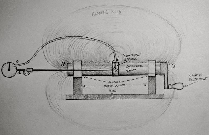

Here's a sketch I did of Faraday's apparatus for this experiment:
The problem he designed this apparatus to obviate is that you can't cut a conductor twice with the same field line (or lines) and get a current. The second crossing of the conductor by a field line produces an EMF in opposition to the first, and they cancel each other out. So, if you try to generate a current by simply laying a conductor alongside a rotating magnet, it will be cut twice by all the field lines, once as they 'emerge' from the magnet, and a second time as they 're-enter' it.
To get around this problem he routed one of the leads (labeled a b in the drawing) through a hole right up the center of the magnet. It terminates in a slip ring at the "equator" of the magnet. From there conductor c b returns to the meter. c b maintains contact with a b by spring pressure onto the slip ring, and the electrical circuit is complete. Section a d of the conductor is both parallel to the field lines and rotates with the field lines, therefore it is not "cut" by them. Section c b is stationary with respect to the rotating magnet, and is always cut by the field lines. This is a continuous direct current generator; really just a different form of his unipolar dynamo.
After looking at your drawing for a bit, I think that if the field DOES rotate with the magnet then the length BC would have a voltage induced in it, but if the field does NOT rotate with the magnet then the length BD would have a voltage induced instead. No wonder people have been discussing this wretched thing for so long!
This setup cannot duplicate the experiments that I referenced in post #22 because the magnet cannot rotate by itself. With this setup the ring commutator always rotates with the magnet. You may think that this would make no difference. But one of the things that makes this problem so puzzling is that it defies intuition. This setup can be duplicated with the experimental setup that I referenced in post #22 by having the copper disc rotate with the magnet. In which case, it too would also produce an emf. It is only when the magnet rotates by itself, and nothing else, that no emf is observed. By the way Zooby, nice job with the sketch.
This is a good point. Length b d is quite short, but it would "cut" the most intense possible part of the field if revolved with respect to that field. If the field were not rotating we would indeed expect a current to be generated there when the magnet is rotated.
I've been pondering this, and I think there must be a way to rule it out. I believe that if you substitute a thicker wire for c b you should get more current: more field lines will be cut per unit time. So, if that suspicion is correct, and there is a difference between the current with the present wire and that of a thicker wire, we could rule out the generation of current in length b d. (The difference between the two wires would be that it would require more force to rotate the magnet at the same speed. Conservation laws, etc.)
However, I'm not rock solid certain a thicker wire should produce more current, and I haven't been able to find any information that clears this up in my mind.
I'm vaguely familiar with the set up you're talking about from a discussion of it here some years ago. My point in focusing on this set up I've introduced here is that it strikes me as easier to work with. If we can use this to prove the magnetic field rotates with the magnet, it will require people to explain the odd results of any other set up in some way other than proposing a non-rotating field.
TurtleMeister wrote: "This setup cannot duplicate the experiments that I referenced in post #22 because the magnet cannot rotate by itself. With this setup the ring commutator always rotates with the magnet."
So remove the disc, the left-hand part of the magnet, and the slip ring joints. The field where the disc used to be is now nonuniform but that doesn't matter. The circuit is now from one pole of the meter, along the rotation and field axis to the bent wire bit where the disc used to be, and out through the field lines back to the other pole of the meter.
We're all agreed that if the meter + wire are rotated around the axis of symmetry we'd read current, yes?
If the meter and wire are held still and the magnet handle cranked we should see no current.

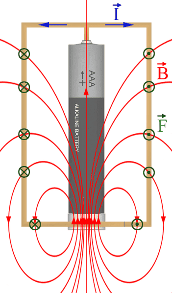

I don't know whether this will help, but I found it to be a useful way of looking at a Faraday Homopolar machine when the disk and magnet are moving together.
For reasons unclear to me, there appears to still be discussion as to whether the magnet field rotates with the magnet when the disc rotates.
To remove this possibility in this scenario, do not use a disc magnet but a simple small magnet.
https://www.physicsforums.com/threads/faradays-paradox.763966/page-2
  • #33
Just to be clear, let me paraphrase your explanation.
It sound like you're saying that when the disk and magnet rotate together, the leads connecting the center and edge of the disk to the meter remain stationary in the lab frame, creating a situation where there is relative motion between the magnetic field and at least one of the leads. The magnetic field, therefore, cuts this lead and generates a current that is detected by the meter.
The second scenario you describe is where the magnet and disk are held stationary in the lab frame, but the leads and meter are rotated around the magnet. Here again, the magnetic field "cuts" the leads and generates a current that can be read at the meter.
Did I understand your post correctly?
