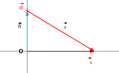

When deriving the magnetic field strength due to a circular loop at some distance away from it's center (using Biot-Savart's law), why is the angle between ds and r 90 degrees?

##\vec {dl}## is in the ##yz## plane. As drawn it is in the negative ##y## direction, so that ##\vec {dl} \perp \vec r## for the ##r## in the ##xz## plane. From Pythagoras you have ##R^2 + x^2 = r^2##. All ##\vec r## have the same length (from symmetry - rotation around the x-axis) - so this ##R^2 + x^2 = r^2## is true for all ##\vec r## -- so all these are rectangular triangles

The ##\vec r## as drawn in the picture is in the xz plane. The ##\vec {dl}## as drawn is perpendicular to the xz plane: it is in the negative y direction. So that ##\vec {dl}## is perpendicular to that ##\vec r##.
For all other ##\vec {dl}## (in the yz plane) you can see they are ##\perp## 'their' ##\vec R## and also ##\perp## to the x-axis, so ##\perp## the plane in which their ##\vec R##, the x-axis and also ##\vec r##.

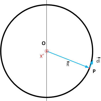

No, not just because yz ##\perp## xz. Because ##\hat y \perp## xz for the situation as drwn in the video. In general:
Point P goes around the ring. At all such P $$ \vec {dl}\perp \vec R \quad \& \quad \hat x \perp \vec {dl} \quad \Rightarrow \quad \vec {dl}\perp (\vec x - \vec R) = \vec r $$

I lost you at dl perpendicular to x - R, why did you do that? And why is it equal to r?
dl is perpendicular to ##\vec R##
dl is perpendicular to ##\hat x## so dl is perpendicular to ##\vec x##
that means dl is perpendicular to the plane in which both ##\vec R## and ##\vec x## lie.
That plane is described by ##a\vec x + b \vec R##.
The vector ##\vec r## is ##\vec R -\vec x## so it is in that plane.

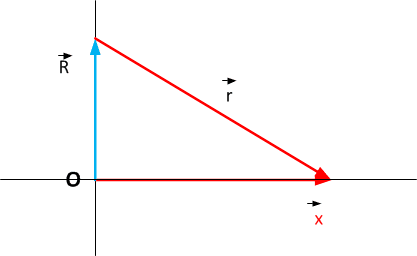

Why is ##\vec r=\vec x -\vec R## ?
i don't know how to say that. Perhaps a picture helps ?

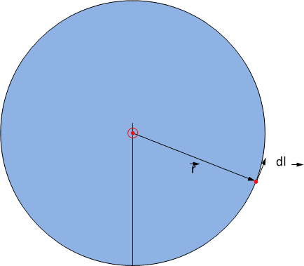

Okay, I see where x - R comes from.
So this is how I'm comprehending it:
dl is pointing outwards (imagine a wire pointing out), so any r from its surface is perpendicular to it.
Before, I was confusing dl with the z vector. The angle that r makes with z will not be perpendicular.
