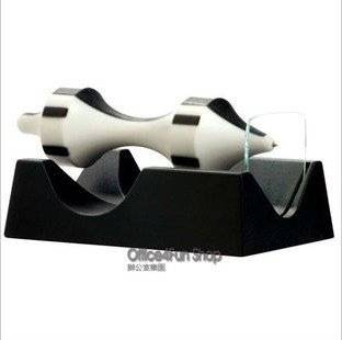

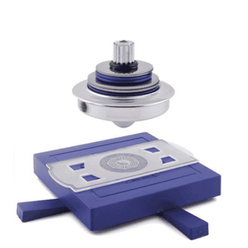

have you not seen those toys that do that ?
America-Carlisleco-magnetic-font-b-levitation-b-font-font-b-pen-b-font-spin-freely-desk.jpg

It will not be possible to have them hang motionless in air, but it may be possible to have them attracted upwards such that they stay on the bottom side of the cardboard. The former isn't possible because passive magnetic levitation is unstable. Both of the toys shown in Davenn's post require something to stabilize them. I believe the clear plastic screen at the tip of the first toy stabilizes it and keeps it from moving forwards until it falls to the table, and I assume the 2nd toy is spin-stabilized, but I'm not certain.
