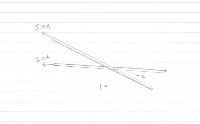

Two insulated wires cross at a 30 degree angle but do not make electrical contact. Each wire carries a 5.0 A current to the left through their respective wires. There are two points. One point lies between the bottom 150 degree angle, and the other lies between the right 30 degree angle. Each point is 4.0 cm from the intersection and equally distant from both wires. What are the magnitude and direction of the magnetic fields at points 1 and 2?
B = [(mu)I]/2(pi)r
I1 = I2 = 5.0 A
r1 = r2 = 0.040msin75degrees = 0.039m
r3 = r4 = 0.040msin15degrees = 0.010m
Bwire1onp1 = Bwire2onp1 = [(Mu)I]/[2(pi)r]
=[(1.257 x 10^-6 T*m/A)(5.0 A)]/[2(pi)(0.039 m)]
=2.6 x 10^-5 T
Bwire1onp2 = Bwire2onp2 = [(1.257 x 10^-6 T*m/A)(5.0 A)]/[2(pi)(0.010 m)]
=1.0 x 10^-4 T
Since Bw1onp1 and Bw2onp1 are both out of the page, then they add to give 5.2 x 10^-5 T out of the page
Since Bw1onp2 comes out of the page, and Bw2onp2 goes into the page, then they cancel to give 0
This doesn't seem right to me, can anybody tell me if I'm doing something wrong please?
Could you please show a picture? It is not clear where those points are.
ehild
You are right.
Your calculations and approach seem to be correct. The magnetic fields at points 1 and 2 will depend on the orientation of the wires and the direction of the current flow. It is possible that the fields cancel out at point 2 due to the wires being at a 30 degree angle, resulting in opposite directions of the magnetic fields. However, it is always important to double check your calculations and make sure you are using the correct equations and values. Also, be sure to consider the direction of the magnetic field at each point, as it is a vector quantity and can have different directions at different points.
