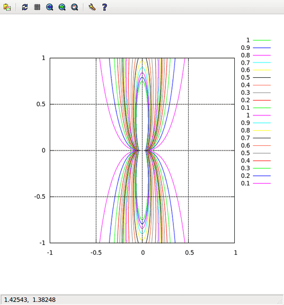

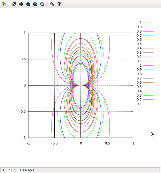

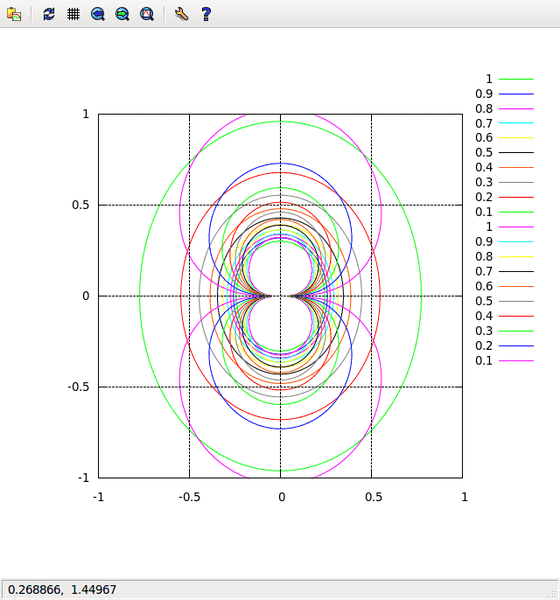

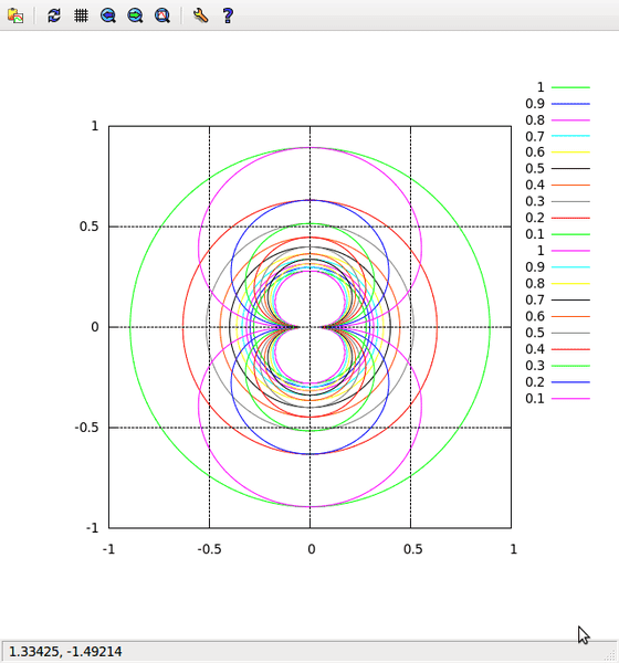

For now, have a look to the transition of lines for:
v = 0.01 c << c (gamma = 1.00005..)
v = c/2 (gamma = 1.1547..)
v = c sqrt(3.)/2.(gamma = 2)
v = .99 c (gamma = 7.09..)
But before, let me explain the meaning of lines you'll see. To represent a vector field in a 3D space several choices can be made: e.g. little arrows here and there, or flux lines... Here, we can rely on the intrinsic problem's cylindrical simmetry, and concentrate to a xy plane, where x-axis is the charge's trajectory and y-axis is any straight line orthogonal to x passing throught the charge's instantaneous position. At any point of the xy plane, E is radial, i.e. directed to or from the charge in the origin (even at relativistic speeds); and B is orthogonal to the plane. So, the only additional information needed for each point is absolute value of fields: |E| and |B|.
I represent them with "level curves" iso|E| and iso|B|, lines where |E| and |B| have the same value (seen in legend).
In the first figure (non-relativistic speed), you can easily recognize iso|E| isolines: they are nearly perfect concentric circles. Other isolines are iso|B|.
Increasing v, isolines are deformed, but they remain recognizable.
Remember, the magnetic field flux lines are orthogonal to the screen, entering in it in a sempilane delimited by the x-axis and emerging from it in the other semiplane.
v << c (gamma = 1.00005..):
v = c/2 (gamma = 1.1547..):
v = c sqrt(3.)/2. such that gamma = 2

Wow, this is really good and is amazing. I have to work all this out but I definitely appreciate this. I couldn't find anything like the above anywhere.
