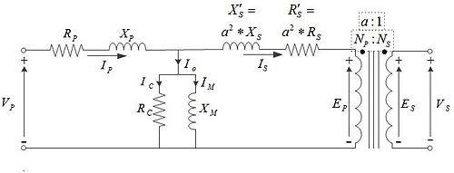

In that picture, note that any secondary current allowed to flow creates a second mmf that affects magnetic flux. Primary current will rise to re-establish flux to Vprimary / Lprimary. So, ignoring magnetizing current , primary amp-turns will be equal to secondary amp-turns . That's the heart of those equations relating ratios of turns voltage and current .When you're ready to tackle ideal vs non ideal transformer the Wikipedia article has a pretty decent model. Tim9000 and i went into it at length a couple years ago.
https://en.wikipedia.org/wiki/Transformer
It has an ideal transformer a:1 surrounded by components representing the real world deviations from ideal.
Observe its magnetizing IM current flows down through XM .
old jim
