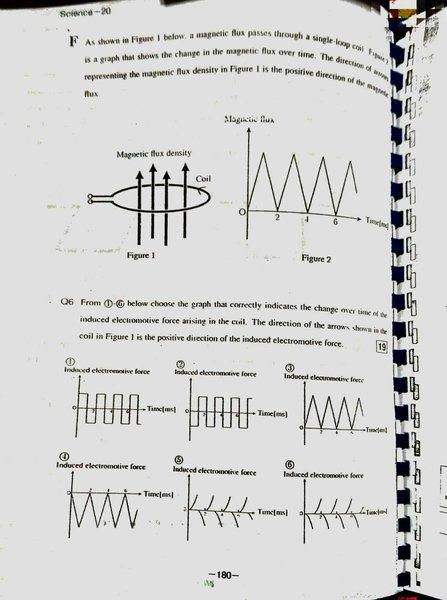

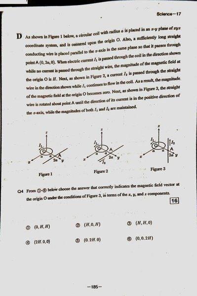

One of my students has given me some Japanese university exam paper questions for Physics (NOTE: I'm a maths teacher). I'm finding them very difficult to answer. I think I've got the answer for the first two but I would like to double-check here. I am pretty confused by the third one, which is quite embarrassing.
First One: I got (2) (H, O, H) by using Fleming's second right-hand rule and the equation for Magnetic field strength being directly proportional to current, and inversely to the distance from the wire
Second One: I got (2) By using Faraday's Law and Lenz's law. Looking at the constant change in flux against time, and the graph flipped over the x-axis due to Lenz's law telling us that an induced emf opposes the change which causes it.

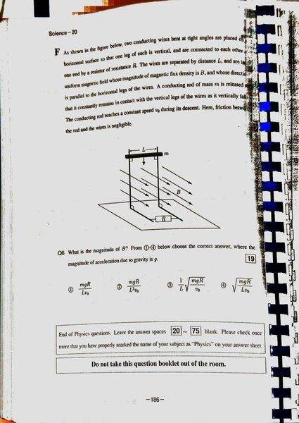

Third One: I'm stuck to be honest

For the 3rd question, write the force balance equation for the rod. Which forces act on the rod as it descends?

3rd question:
At constant velocity I have that mg would equal BIL
Then I'm stuck. The magnetic flux would be constant since it's a uniform field. But I can't see how to get to one of the answers
Correct, and what is I in terms of the given quantities?
Current flows in the rod because of the motional emf. Look up the equation for motional emf.
Or if you want to use the flux rule, calculate the rate of change of flux w.r.t. the loop. The loop gets smaller as the rod descends and hence, the flux in the loop is changing. This way, you'll derive the motional emf equation.
Likes BeginnerPhysicsMan
Ah, I got number 3
Thank you very much
Ah, I got number 3
That is correct.
