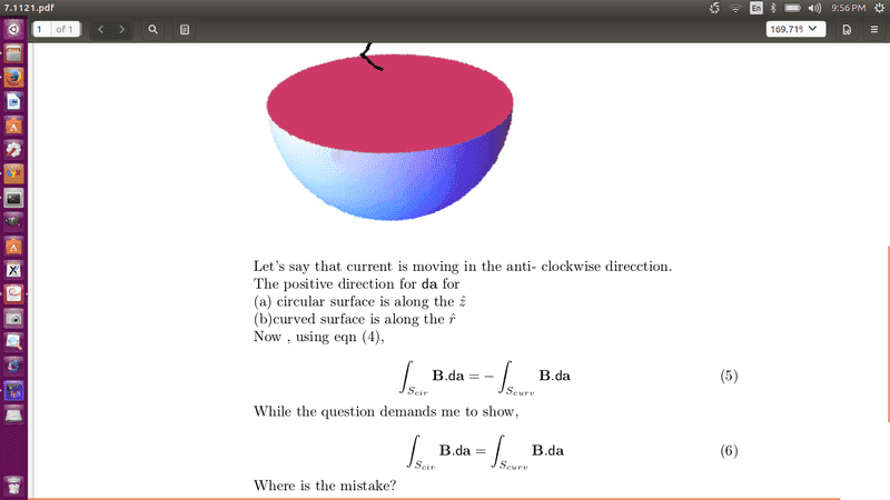

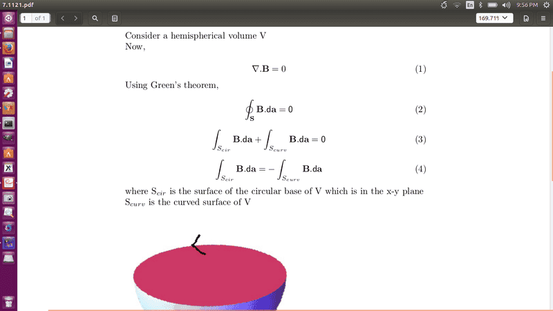

While applying Green's theorem,
the positive direction of da for curved surface is ##\hat r## .
But in the second case , for calculating flux through the curved surface when the current is flowing through the ring, the positive direction of da for curved surface is -##\hat r## (as if I approximate the curved surface by a plane surface then the positive direction of da for this surface is ##\hat z## which is possible only if the positive direction of da for curved surface is ##-\hat r##) .
Hence, flux through the curved surface in the first case i.e. Green's theorem is negative of the flux through the curved surface in the Second case.
Hence, using the above fact and eq.(4), eq.(6) could be shown.
Generalizing it, magnetic flux through all different surfaces bounded by the same boundary line is same.
Is this correct?

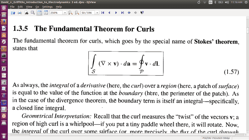

Green's theorem is just the special case of Stokes's theorem applied to a two-dimensional figure. At least that's the consensus. So I have a problem with the wording in the graphic of post 9.

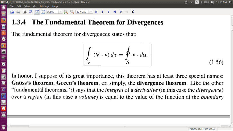

I have never read that Green's theorem is a special case of Stokes' theorem. Will you please give me a reference (to read)?
Well, then what I am applying is Gauss' theorem, not Green's theorem.'
And Gauss' theorem is not a special case of stokes' theorem. Right?
https://en.wikipedia.org/wiki/Green's_theorem
Read top paragraph.
There are really two theorems, quite different from each other. I call them the Divergence theorem and the Stokes theorem. "Green's Theorem" seems to lead to all sorts of confusion; in post 20 "Green's Theorem" even refers to the Divergence Theorem. A legitimate synonym for the Divergence Theorem is "Gauss's Theorem". In electrostatics it's often used to mean the Divergence Theorem as applied to one of Maxwell's equations: ∇ ⋅ D = ρ which in integral form becomes

No. You need Stokes's theorem as post 8 first mentioned.

In coming from eqn 1 to 2, I have used GAuss' theorem.
∇.B dΓ = ##\oint_S ##B.da = 0
