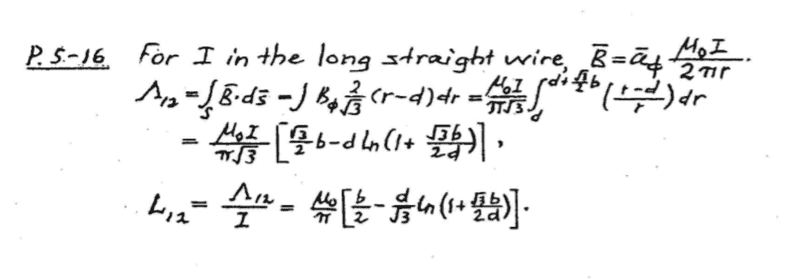

Determine the mutual inductance between a very long, straight wire and a conducting equilateral triangular loop
I know how to do it but I'm stuck at the step of finding the total inductance through the triange.
we know that the magnetic field due to an infinitely long wire is
B = µI/2πr
in order to find the magnetic flux through the triangle we need to find Φ = ∫B.dA
we have B but what would dA be in this case
the book says it's (2/√3) * (r - d) *dr
why is that so?

this is how it is in the solution manual perhaps if you take a look you could understand how it was derived
I just couldn't figure it out

I see what they did there. Since the wire in infinitely long, B is only dependent on r, the distance from the line.
So, if you slice up the equilateral triangle vertically, along lines with the same distance to the wire, you get
##\int\int B \, dA = \int B h(r) dr, ##
where ##h(r)## is the height of the triangle at distance r.
At r=d, the height is 0, and at r = ##d+b\sqrt{3}/2##, the height is b. So you can make a linear rule for the height that looks like
## h = (r-d)\frac{2}{\sqrt{3}} .##
Check that against the reference points to make sure.
So, now you can treat the integral in terms of one variable, r.
##\int B h(r) dr = \int B (r-d)\frac{2}{\sqrt{3}}\, dr ##
The final answer applies a simplification in the natural log, but otherwise, you should be able to follow the rest from there with about 2 extra steps.
