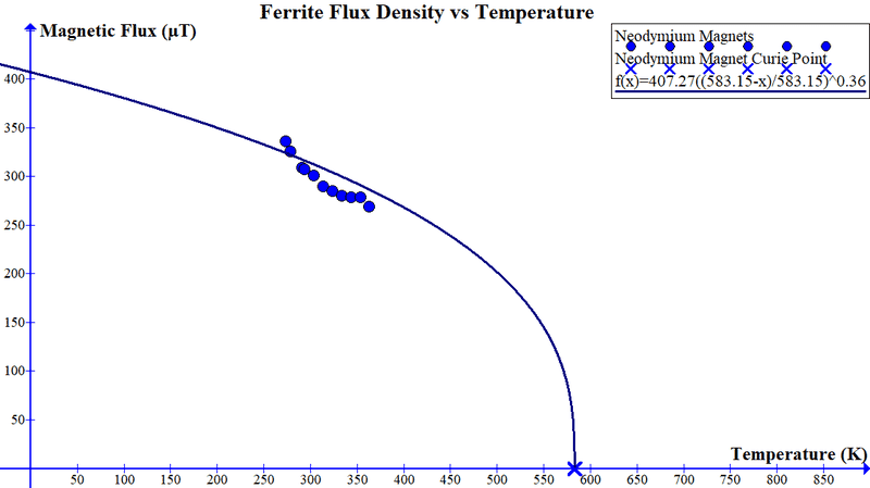

By additional inputs, do you mean did I measure any other variables other than magnetic flux? Unfortunately, I didn't, and wish I had in hindsight. How did you find the equation that you posted above [M/Mo = ((Tc-T)/Tc)^0.36]? The picture of the graph doesn't even give a formula. Could you please send me the information on the renormalization group theory and the equation? I don't actually have the Nigel Goldenfeld book.
Would I be able to calculate a value of y from my datasets, or should I just use the approximation of y = 0.32 given by the book? I can see how you can convert B to H by using M = Mr x Mo and substituting M into B = M x H, but how would I find values of B outside my measured temperature range (0-90 C)? Is this covered in the book as well?

From the relationship you gave me, M/M0 = ((Tc-T)/Tc)^0.36.
I know what temperatures I measured the flux density at, so I can find what fraction of the Curie temperature that is and use the graph to find what M/M0 was for that temperature. How do I find M0 so I can substitute it into M/M0 = ((Tc-T)/Tc)^0.36, to find M, then substitute M into my flux formula?. Could I find what M0 is using T/Tc = 0?

Very good. Yes, ## M_o ## is the magnetization of the permanent magnet at ## T=0 ## K, and I'm pretty sure, at least for best results, the geometry needs to be a long cylindrical shape. (and not spherical, etc.). Your data point at the lowest temperature you measured will be reasonably close to this value. ## \\ ## ( ## M_o ## for the material should also be available in a google. Let me see if it shows up... They give 1.6 T, but that is for a very high quality special compound ## Nd_2Fe_{14}B ##. If you got something in the neighborhood of 1.0 T, it is probably reasonably accurate...Note: For units, use ## B=\mu_o H+M ##, so that ## B_r=M ##. That's the simplest wat to compute it. (Sometimes the equation ## B=\mu_o H +\mu_o M ## is also used=this makes ## M=B_r/\mu_o ##. Your ## M=\mu_o B_r ## is incorrect) . ## \\ ## Yes, you could also extrapolate back to ## T/T_C=0 ##. The one problem you will likely have is you didn't go to extremely high temperatures. Note: My computer was unable to read the .png data sets. I'm very curious to know though, what did you get for ## B_r=M ##? ## \\ ## One additional item you might find of interest, since you are on the subject of magnetism is a PhysicsForums Insights article that I recently authored. https://www.physicsforums.com/insights/permanent-magnets-ferromagnetism-magnetic-surface-currents/ I didn't go into a discussion of the quantum mechanical exchange effect in this article, but it might give you some introduction into permanent magnets.

Try this "link": https://en.wikipedia.org/wiki/Remanence ## \\ ## I'm curious=what did you get when you computed ## B_r=M_o ## from your data?
By substituting Br = Mμ0 and M = M0 ((Tc - T)/Tc)^0.36 into B =
) and rearranging, I got M0 = 0.1233T, but it seems too low, as you mentioned above it should be somewhere around 1T. This would give Br = 1.55 x 10^-7 ((583.15-T)/583.15)^0.36, which doesn't make sense at all, as Br should be about 1T for neodymium magnets. Also, when I substitute the value of M0 into my flux formula, it gives B = 1.12 x 10^-10 (((583.15-T)/583.15)^0.36, which is thousands of times lower than what my data actually is.
I've checked the calculations multiple times and can't see anything wrong, so I'm figuring I've messed up somewhere in constructing my formula.

B = 3.47 x 10^-4 T at 20 degrees C, so 293.15K at about 25mm away from the meter, where L = 39mm and R = 3mm.
The ## M_o=B_r=.12 ##T looks sort of ok. I think you got the arithmetic correct=I estimated it, but didn't compute it with a calculator. I presume in the data you gave me that ## X=25 ## mm. It might not be a very high quality magnet that you have. Meanwhile, the formula reads ## B_r=M_o ## without any ## \mu_o ##, at least in the units I have been using. If you write ## .12=M_o (1-295/583)^{.36}=M_o (.8) ##(approximately), so that ## M_o=.15 ## T which could be reasonable for a low quality Neodynium magnet. It could perhaps also be due to errors in the measurement of the magnetic field ## B ##.
@Scoopadifuego, the Neodymium magnet we used was pretty low quality in comparison to other Neodymium magnets so this is actually quite justifiable.
Likes Charles Link
From all appearances, your experiment was pretty successful. I don't know how accurate your meter is that measured the magnetic field strength, but if it was accurate, then you might simply have a Neodynium magnet of only moderate strength. Your data collection and formulas look good. :)

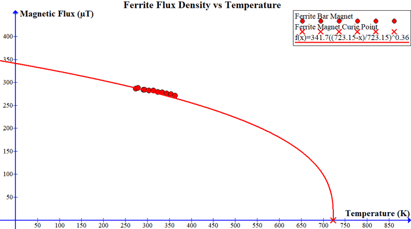

@zac_physics_student and @Scoopadifuego Besides the "link" mentioned in post # 7, one posting that you might find of interest for calculating the magnetic field ## B ## from a bar magnet is the following "link": https://www.physicsforums.com/threads/magnetic-field-of-a-ferromagnetic-cylinder.863066/ The formula you used in post #6 and #11 is correct, but if you are interested in how this formula gets derived, it comes from doing the Biot-Savart integral from the magnetic surface currents at a point on-axis. ## \\ ## And I enjoyed working through this laboratory experiment on the Curie temperature with you. It is a very interesting laboratory experiment. :) :) ## \\ ## One additional idea that I had for an experiment such as this: Your magnetic field meter was probably simply something that you just placed there and it gave you a number. You could alternatively construct your own meter with a compass and the help of the magnetic field from the Earth which is known to be about .5 gauss. You could have your compass needle originally pointing north and then put your magnet to the left of the compass and get it to deflect the compass needle somewhat eastward. e.g. when the compass needle is at 45 degrees, the field from the magnet would also be .5 gauss.
@Charles Link Thank you so much for helping @zac_physics_student and me with this problem. The graphs turned out well, and I wouldn't have been able to do this without your help.

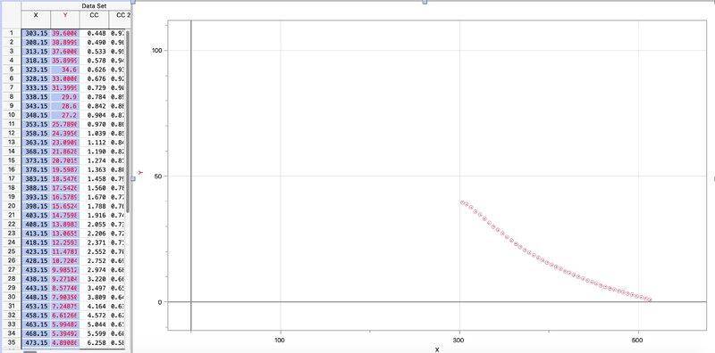

I am doing a similar experiment for an IB assessment, but it turned out to be more complicated than I thought... I measured the field strength of a magnet cooling down from 80C to room temp, but I am struggling with how to process the data for the lab report

This is data I took from an NdFeB magnet where temperature in K is on the x and B in millitesla is on the y. The data doesn’t seem to fit what you all are saying and I wanted to get y’all’s opinions.
Likes Charles Link
In this experiment the magnet is kept at a fixed distance away from the gaussmeter.

The data looks good. Looks like the Curie temperature ## T_C ## is around 500K. The theoretical formula in post 2, ## M=M_o ((T_C-T)/T_C))^{\gamma} ## , would have a more rapid decline at the Curie temperature (see the graphs of post 19), but the theoretical formula may not be exact.
Just an additional comment: The mechanism for a permanent magnet is a rather complex one, and it shouldn't be too surprising if there are some differences between experiment and the formula that comes from group theory and critical phenomena.
One more item: a google gives ## T_C=583K ## for NdFeB magnets, so your data is certainly in the right ballpark.
