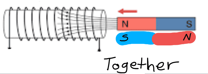

What happens if I spin bar magnets inside a copper wire ring? Instead of rotating 2 separate copper rings inside a magnet that will split different flowing current on to different wires where a brush can join them together, what happens if I do the opposite putting the magnet inside the copper coil WITH ONLY 1 continuous copper wire exposed to both North and South poles simultaneously?
Will current cancel each other out trying to flow opposite direction and only the net difference will flow through the wire? Or will this create an electrical short heating up the wire like a resister?
Could place a diode on one end of the copper wire to prevent flow the wrong direction? Is there anyway I can gain electricity off something like that? I don't have the ability to separate this group of spinning magnets. I want to put them all inside the copper ring? I was hoping the magnetic fields or conflicting currents would cancel each other out? But then I thought what if the wire started to heat up?

Primary use for magnets are for mechanical work. Trying to grab current from them. Single copper coil exposed to N and S poles same time moving In and out of the copper coil side by side evenly but spaced a part a little. BUT one magnet stops moving 50% of the time remaining inside with no movement. Both magnets enter copper coil half way.
There are two issues here:
  1. A single continuous coil with one magnet rotating will in fact produce alternating currents and heat in the coil.
  2. If I understand, in your "two magnet" setup one magnet will largely cancel the other one. Most of the magnetic field from one will be pulled into the other and vice-versa. May I recommend a simulation program (vizimag) that has a 30 day free trial. See if you can simulate some magnets and play.

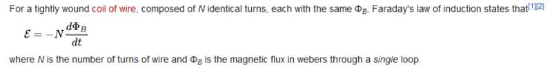

Are you familiar with Faraday's Law for Electromagnetic Induction? Basically to maximize the voltage that is induced in the coil by the moving magnet, you need to maximize the change in the B-field with respect to time:
$$ V(t) = - N \frac{d \phi (t)}{dt} $$
Where ## N ## is the number of loops in the coil that the magnetic flux ## \phi ## passes through. In order to maximize ## V(t) ## you need to have maximum flux change and maximize the speed with which that flux changes.
How does your proposed geometry accomplish those goals?

Thank you both. I will look at the magnetic simulator thanks. As I understand I will gain "nothing useable" with both magnets, heat up my wire. Next pass in when a single pole is inserted to the loop, the wire loop will be left heated from previous interaction. Too much opposing current maybe hot enough to damaging coil. Thank you both. :) This idea won't work.
PS. I wonder if I'm able to cool the wire down? I doubt a cooling fan is going to make much difference. It's alternating passes. 2 magnets and then 1 magnet at high velocity, it's unlikely I'll be able to cool the wire down within that fraction of a second? I'll have to test it to see how hot it gets. I think it's going to heat up immediately but I can test it. Thank you. :)
