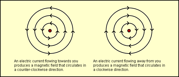

You are aware that B circles around the wires right? The position of the wires is important too, to find the field at P. Why don't you draw a picture with both the wires, and the directions in which B circles around each. It is clockwise around the (3,0) wire, and anticlockwise around the (8,5) wire.

I feel really stupid asking this, but if B circles around the wires, how can you draw a vector and say that B is straight down, or to the right? Isn't it technically moving around the wire, and not in anyone direction specifically?
This is what I mean when I say B circles around the wire:
At any given point, it has a direction. (B is a vector field, with a direction and magnitude at each point.)
At and given point, it has a direction.
But what determines why when the current moves into the page it has a magnetic field that is straight down, and when a current moves out of the page it has a magnetic field that is to the right?
This is so damn confusing!
You are forgetting about the point P. Look at the right picture above. It shows a wire with current into the page. Take this and impose it on your original diagram. And then, at the point P, see in which direction the lines are pointing.
Oooooooh! Okay, this makes perfect sense! So, there are essentially two magnetic forces acting at P, the one straight down and the one to the right, which added together give a vector 45 degrees down and to the right.
