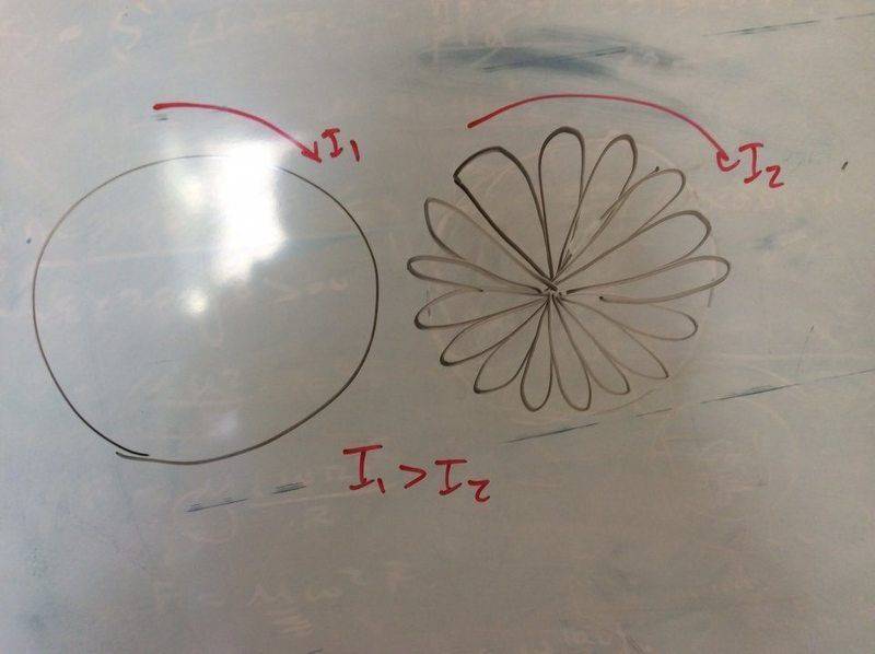

Hi,
I am working on an experiment to investigate the effect of electrical conductivity of the metals on the levitating force produced.
Basically the concept is this: when a metal plate is placed on top of a solenoid (but not touching), as the a.c. flows in the solenoid the change in magnetic flux induce eddy current in the metal plate. The eddy current will flow in a direction such that it opposes the magnetic field that induces it, so a repulsive force will be produced between the solenoid and metal plate. I thought conductivity of metal would affect it as the higher the conductivity the larger the eddy current induced.
The problem here is, does paramagnetism, diamagnetism or ferromagnetism affect the repulsive force between the metal plate and the solenoid? Also, does the shape of the metal plate affect the eddy current produced within it? Can I use a flat, square metal plate to substitute metal ring?
Yes the shape effects current

Also I B distance between the two objects---effects force between the two objects
The material type will affect the magnetic permeability (µ). For example diamagnetic materials often have µ<µº. (They are sometime anisotropic which makes µ a second order tensor.) This will of course affect your measurements.
Likes smokedvanilla
What the does the shape of the loop in I2 represent?
Page 2 in this link http://www.innospection.com/pdfs/Eddy%20Current%20Theory.pdf talks about eddy current in cubic/cuboid metal plate, so I deduce that metal plates are also capable of producing repulsive force against the solenoid.
I see. So I deduce that paramagnetic and ferromagnetic materials will be able to produce repulsive forces while diamagnetic will not? (Since the difference between ferromagnetic and paramagnetic materials is the ability to retain magnetism in the absence of external magnetic field.)
No, it should still repel. The amount will vary.
For ferromagnetic material, it will attract as well. You will have to run the numbers to see which effect dominates in which material, geometry, and magnetic field.
BTW, you should read the Wikipedia pages for the different types of magnetism.
Noted. Thank you! :)
