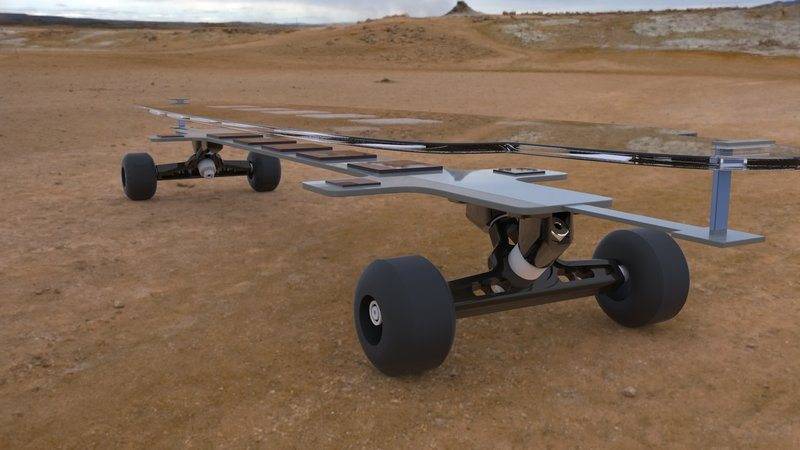

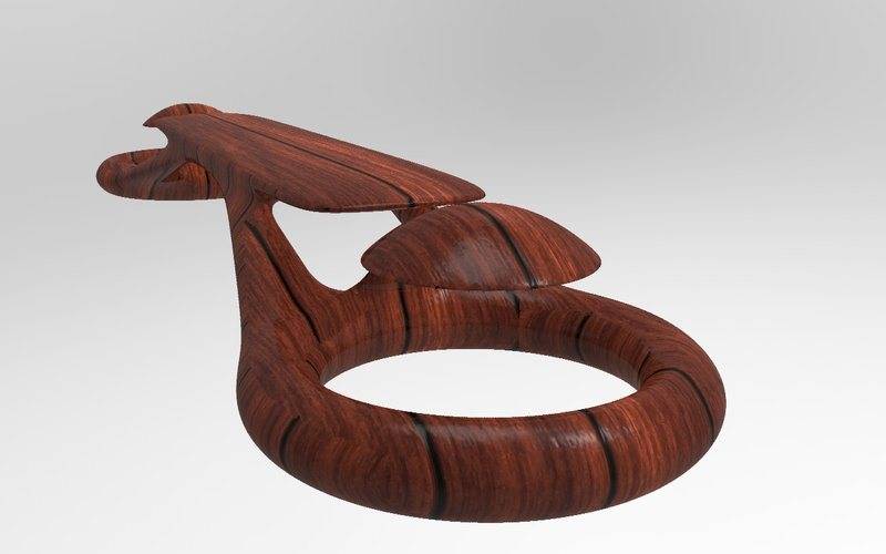

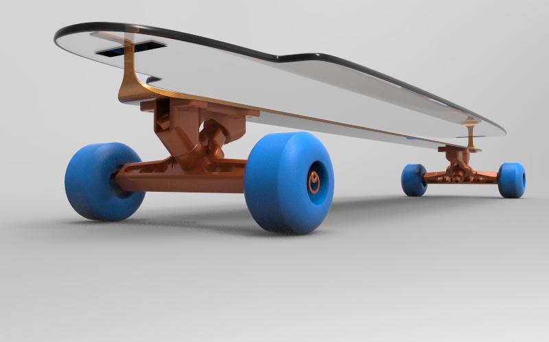

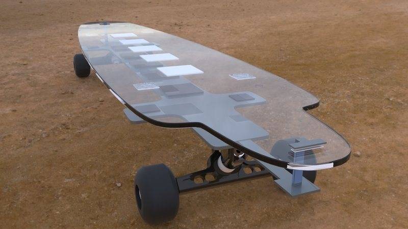

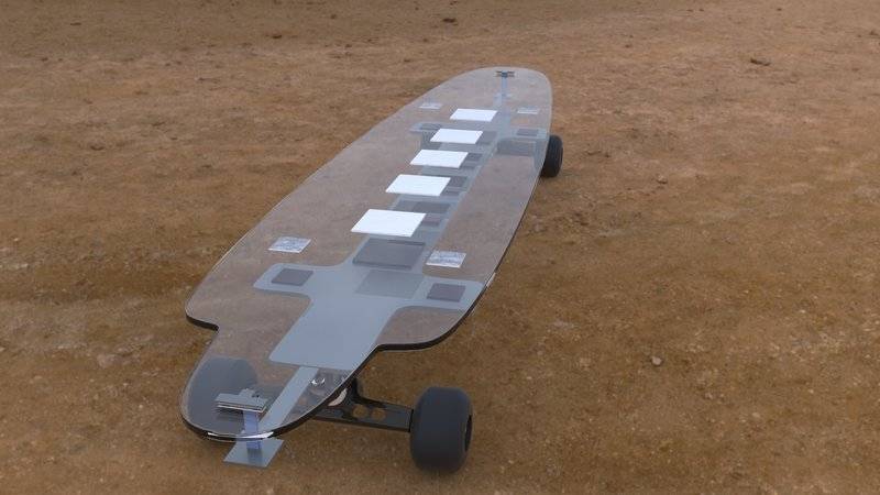

the only thing i have at the moment are renders of the concept, which i have included in this reply, , as far as the stability of the floating board, i have the vertical lift sorted, i have the rotational aspect sorted and i have the lateral control sorted, as i said in an earlier post, i am talking to companies about getting the final magnets engineered, their height is causing major issues, but all potential problems as far as preventing the magnets from attracting has been taken into account

Ah, it is supported at both ends.
I would expect that there are easier ways to make a "soft" board, but it looks like an interesting concept.
Spring suspension, comes to mind. I would expect a skateboarder to want a better feel of contact with the ground than a soggy suspension, though. Certainly for tricks.
So what exactly is levitating?
Likes sophiecentaur
I was thinking springs as well.
@Mack7963 -- Beautiful work. You could win an Industrial Design award with that kind of work. I don't think the magnet thing will work out for you, but you have a lot of talent in Industrial Design. :smile:
the top board
i will take that complement about the design and pay for it with thanks, at this stage its no longer about if it will work or not, now its about getting it to that point where my own eyes see the end result, and above all else its been a learning experience, i know more about magnets now than i did 6 years ago, so even IF it fails, i still walk away from this as a winner...just not a rich one :)
as would i if this were designed to be a trick board, taking into account the downward forces generated on landing and the weight of the rider, the magnets would never last past one trick, this is primarily a cruising board, the sogginess of t supportive magnetic field will give a feeling of riding on a liquid, which is where skateboarding came from, surfers, after seeing the 13 second bounce the top board did when pushed down and released was incredibly similar to the motion of a liquid, it will take some relearning as far as control, but i suspect that will be minimal.
one interesting thing i did discover is that the magnets i was using in the live vertical support test, on the bottom board were able to repel the top board far enough upwards so the board cleared the 12" bolts that were keeping the top board in place, that's the weight of the board and the magnets all being propelled upward, add to that the bolts that were acting as lateral anchors, were threaded, and there were 4 of them. which does open up the possibility of tricks still being able to be done, except the board doesn't spin in mid air...the rider does.
Do you have a background in Industrial Design or in Art? Seriously, that is beautiful work. :smile:
i dont, i didnt design the trucks by the way, they were the closest thing to what i wanted i could find in the time i had, i have a very basic working knowledge of a lot of 3d software but no real skill in any of them, the top board and the bottom bar are the only things i designed from scratch.
The trucks are not the beauty in that design. Nice work. :smile:
I wonder if there is a longboard design in your work that you could sell without the magnets part. The transparent board and 2-story deign work so well, and with longboards, you don't have to worry about scratches from tricks. Have you considered making some longboards for general sale without the magnetic floating effect?EDIT/ADD -- I would probably buy one for my son as a gift (he's a longboarder at 22 y/o)
to be honest i hadnt, i but with this developing in the way it has i have been playing around with different shapes, with 3d printing so cheap, and the added bonus of the magnetic field that will support the weight will also act like a pillow, in other words, there will be no point that the riders weight will cause a critical failure of the top board because the bubble supports the board equally, that in turn means that boards can be made thinner, haven't done any actual testing yet but from what I've seen so far everything would indicate that if you filled a bag with a viscous liquid and placed a board on the bag, the magnetic bubble would support the board i the same way that the bag of liquid would the object, as far as the long board suggestion, absolutely.

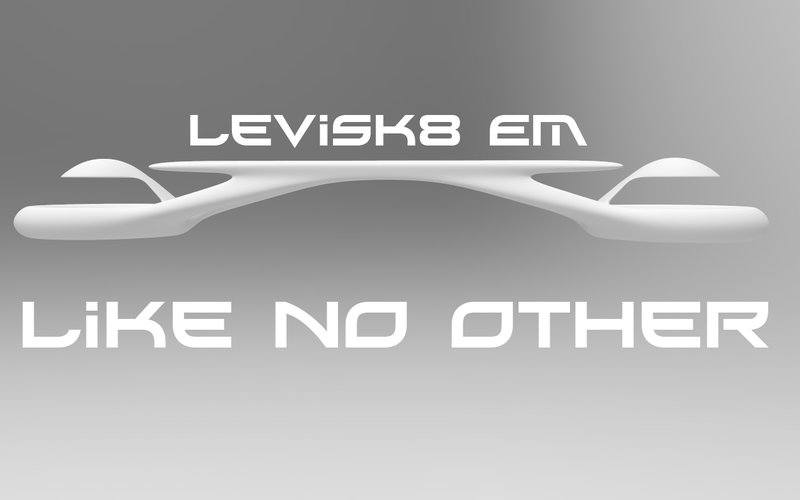

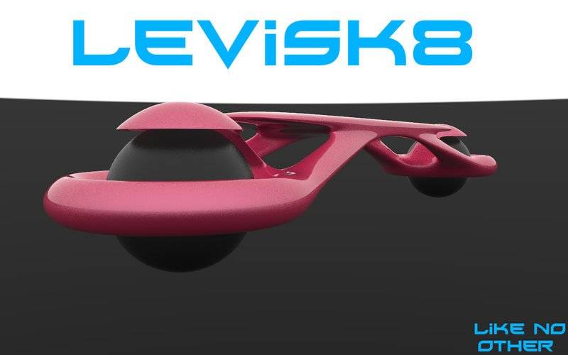

So, i figured that youd like an update on the Leviskate PM, after realising that a radial array of magnets i the configuration i wanted them in was going to cost anywhere from £1500 to £2800 to have made i started to think that it may turn out to be an idea that has zero appeal due to manufacturing cost, then for some reason while i was in rhino designing a second hoverboard it came to me, a way to do exactly the same thing as a radial magnet but without the costs, anyway, basically ill be doing some tests this week and posting them on you tube, the links wil be posted on her,
just as a side note this is what i was designing when the idea for came to me, it was going to be an electromagnet hoverboard, till i found out that if elctromagnets are constantly on they tend to melt, sooo. it would have been so pretty as well :(
