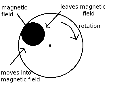

Here is an image:
A permanent magnetic field with a rotating disk. All the time, parts of the disk enter the magnetic field, and other parts leave it, leading to a time-dependent field for those regions, and therefore a braking force.

Just to be crystal clear:
That spinning disc is just all aluminum?

Anything conducting will work, aluminium is conducting.
