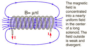

I'm not quite sure how to go about this problem, could anyone please explain it?
Magnetic field of a solenoid:
Where n=N/L
Answer: 5.0µm
Hi Nn,
Your relevant equation isn't for a simple straight wire. Look e.g. here
Oh, and: next time use the template as it's intended (I.e. show some work under 3, not the answer from the back of the book) :)
BvU said:
Hi Nn,
Thanks for pointing that out! I didn't know how to calculate it, so I put the correct answer there for those who could help
