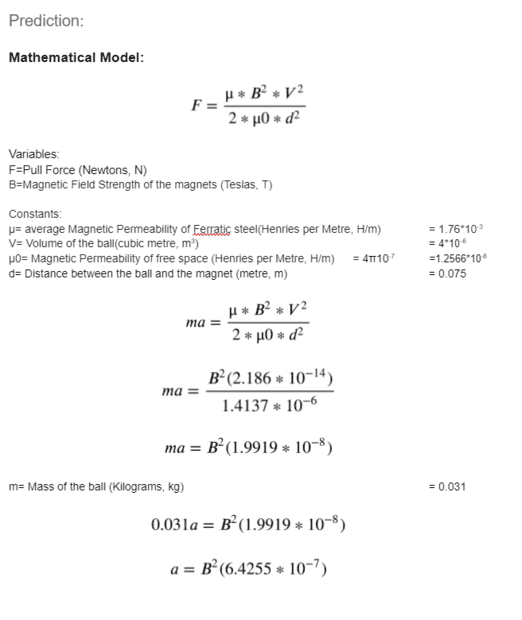

The plan was to calculate the magnetic pull force using the first formula: F = (μ * B^2 * V^2) / (2 * μ0 * d^2)
This formula was taken directly from this site, as it seemed to be exactly what I needed: https://www.physicsforums.com/threads/calculate-magnetic-pull-force-for-steel-ball.743775/
μ, magnetic permeability of ferratic steel (the material of the ball) = 1.76*10^-3
V= Volume of the ball(cubic metre, m^3) = 4*10^-6
μ0= Magnetic Permeability of free space (Henries per Metre, H/m) =1.2566*10^-6
d= Distance between the ball and the magnet (metre, m) = 0.075
The values for B (magnetic field strength) were calculated using this calculator: https://www.kjmagnetics.com/fieldcalculator.asp

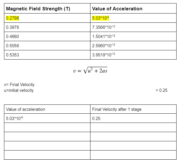

Here is the table of thickness of the magnets with the field strength 75mm away from them
Then, the next step was to substitute the pull force value into the formula F=ma, to calculate the acceleration.
m=mass of the ball (Kilograms, kg) = 0.031
The image above is a picture of the final formula, and how I got it. At this point, I knew something was very wrong, as I realized the value of acceleration would be too small to make sense, and that the first formula (F = (μ * B^2 * V^2) / (2 * μ0 * d^2)) was no good.

As obvious, the values of acceleration are way too small. As a result, the final velocity obtained is literally no different from the inital velocity.
I am pretty sure that the first formula is wrong, as the values for pull force that i am getting from it are way too small. For example, using the formula, the magnetic pull force value that I get for a magnet 5.001mm thick and 19mm wide (grade N35) is 5.01*10^-4. However using the magnetic pull force calculator from the same website, the pull force value that I get is 59.11 newtons.

Another example: The value of the pull force that I gained from the calculator at distance = 7.5mm is
3.15823735 newton
However at the same distance, the value I gained from the formula is 4.91*10^-6 newton. I have no idea why.

Calculating the acceleration is very difficult for various reasons including:
- the magnetic field changes rapidly (and non-linearly) over short distances;
- therefore so do the force and the acceleration.
So, for example, you can't directly use 'suvat' equations such as ##v^2 = u^2 + 2as## because acceleration is not constant. It is not cear how you have allowed for the changing force (and hence the changing acceleration) in your calculations.

I can't see the formula in the link. If it's correct, it may be inaccurate here because:
- B is not constant inside the ball;
- distance d isn't defined clearly (need to know the 2 exact end-points).
No units are given. Does your equation use the absolute permeability (1.76x10^-3 H/m) or the relative permeability (about 1400)? If your equation uses relative permeability but you have mistakenly used the absolute permeability, then your value of force should be around one million times bigger!
