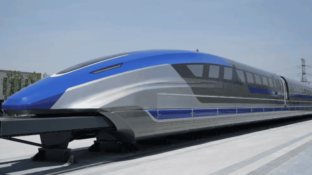

Obviously, the answer is yes and no. If their relative speed is slow enough, yes. If too fast, no.
Imagine a magnetic levitation train that hits a bump. Will it touch the rails? It depends on the speed of the train and the dimensions of the bump.
