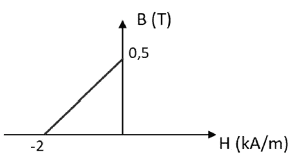

Consider a ferromagnetic material and suppose we can approximate a portion of its hysteresis curve as a segment as shown in the figure. With this material we make a permanent magnet in the shape of a toroid with an overall length equal to ##D = 80 cm## including an air gap with a thickness of ##h = 5 mm##. Calculate the magnitude of the magnetization vector ##\vec{M}## of the magnet.
##\vec{H}=\frac{\vec{B}}{\mu_0}-\vec{M}##
I have thought about the following
##\oint \vec{H}\cdot d\vec{l}=0\Leftrightarrow H_{int}(D-h)+H_{ext}h=0\Leftrightarrow (\frac{B}{\mu_0}-M)(D-h)+\frac{B}{\mu_0}h=0\Leftrightarrow M=\frac{D}{D-h}\frac{B}{\mu_0}## but (supposing what I have done is correct) I don't understand which value of ##B## I should take: perhaps the one at ##H=0\frac{kA}{m}##, namely ##B=0.5T##?
Thanks

This one is not simple, but you got a good start, with ## \oint H \cdot dl=0 ##, so that ## H_{inside} \approx -H_{gap} h/D ##. To a good approximation, ## H_{gap}=M ##, from the pole model of magnetostatics, (compare to the computation of ## E ## with two planes of surface charge density ## \pm \sigma ##).
From the hysteresis curve, you need to find the linear relationship between ## M ## and ## H ##. Let me write it out for you: Using ## B=\mu_o H+\mu_o M ##, we have one point at ## M=.5/\mu_o=M_o ## and ## H=0 ##. The other point is at ## H=-2000 ## and ## M=+2000 ##. We can write ## (M-M_o)/(H-0)=(2000-M_o)/(-2000-0) ##, and solve for ## M ## in terms of ## H ##.
Combine this with ## H=-M h/D ## to solve for ## M ##.
Edit: alternatively to see that ## H_{gap}=M ##, in the material ## B \approx \mu_o M ##. The ## B ## must be continuous, so that ## B=\mu_o M=\mu_o H_{gap} ##.

You have been very helpful, thank you very much!
Likes Charles Link
and a follow-on: More useful than the value of ## M ## is the value of ## \mu_o M ##. I get ## \mu_o M=.22 ## T. Does this agree with what you obtained?
Likes lorenz0
Perhaps a couple additional comments about the solution of this would be worthwhile. We are given a hysteresis curve that is linear, relating ## B ## to ## H ##. We can thereby write ## B=aH+b ## for constants ## a ## and ## b ##. With ## B=\mu_o H+\mu_o M ##, it should be apparent, without a rigorous proof, that ## M=a'H+b' ##, for constants ## a' ## and ## b' ##, i.e. there is a linear relationship between ## M ## and ## H ##. We made use of this in solving the problem above.
Likes lorenz0
It may be of interest that changing the geometry from that of a toroid to a toroid with a gap made for the solution where we had the line ## M=-160 \, H ## intersecting the hysteresis curve, rather than having ## H=0 ##,
