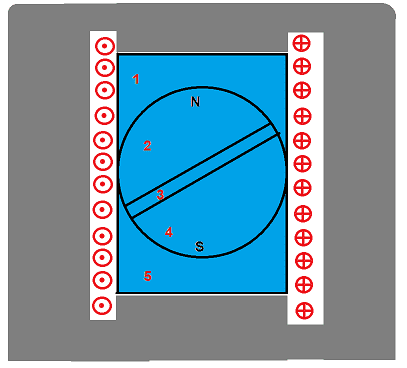

I'm not sure whether you're saying, you can't magnetise a needle obliquely, or if you can, that it won't retain its magnetism?
If the former, could you not use five carefully shaped pieces of iron to 'fool' the magnetic field into going where you want it whilst magnetising the needle? (3 is the needle.)
And to mitigate the latter problem, use these pieces as 'keepers' ? (That might prejudice its utility as a compass! Though a compass that points on a bearing of 71.5 degrees magnetic, may not be the most useful compass in the world?)
