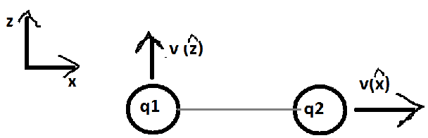

Let's consider the following system at time t.
##\vec B ## due to moving q1 at q2 i.e. ## \vec B_1 ## is along ## \hat y ## direction.
So, the force on the q2 is ## \vec F_{on~q2} = q_2 v B_1 \hat z ##
Taking q2 = q1, it's clear that the strength of magnetic field due to q2 at q1 i.e. B_2 is very small compared to B_1.
So, it's clear that magneto - static force doesn't follow Newton's 3rd Law.This results because both magnetic field due to a moving charge and the magnetic force acting on a moving charge are perpendicular to its velocity.
Is this correct?

Yes, that's right.
Is this correct?
Yes, along with the fact that "the strength of magnetic field due to q2 at q1 i.e. B_2 is very small compared to B_1".

But how are you and the OP concluding that the strength of magnetic field B2 is very small compared to B1 ? Assuming charges are of equal magnitudes , I am not able to see how field strengths are being compared . Is their some implicit assumption ?
The B-field of charge 1 at the location of charge 2 is much stronger than the field of charge 2 at the location of charge 1. In fact the B- field of 2 at the location of 1 is zero.

As depicted in the OP q1 is moving with speed v1 along +z and q2 is moving with speed v2 along +x axis .
B1 (due to q1 ) = ##\frac{\mu}{4 \pi r^2}qv_1sin\theta_1 ##
B2 (due to q2 ) = ##\frac{\mu}{4 \pi r^2}qv_2sin\theta_2 ##
Which of the factors make B1 stronger than B2 ?

In case of calculating B2 at the position of q1 using your approach and considering griffith's footnote 11, ##\theta_ 2 ## ( which is angle between ## \vec v_2 ## and ## \vec r_1 - \vec r_2 ## i.e. position vector of q1 relative to q2) is ## \pi ##, which makes B2 zero at q1.

For a point charge moving at constant velocity, the B field circles around the line of motion of the charge. For the OP's question, the relevant facts are
(1) B = 0 at all points on the line of motion of the charge.
(2) B ≠ 0 at points that are not on the line of motion of the charge.
A diagram of the field is shown here: https://www.miniphysics.com/uy1-magnetic-field-of-a-moving-charge.html
Charge 2 does not produce any B field at the location of charge 1 because charge 1 lies on the line of motion of charge 2. However, charge 1 does produce some magnetic field at the location of particle 2 because 2 does not lie on the line of motion of 1.
Likes conscience
Oh ! I apologise . I didn't pay enough attention to the grey line connecting the two charges in OP's diagram . I was assuming the two charges moving with their instantaneous velocities along the axes but not in the way as shown in the OP .Sorry , again .
