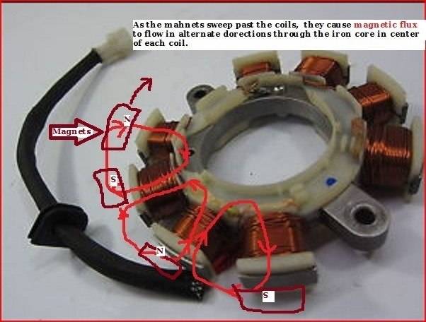

My dad is working on a project where he intends to convert mechanical into electrical energy, and he was wondering if a particular magnet and coil configuration works for electricity generation. And if it does, how are the voltage and current calculated.
Lets say:
  • The coils have a diameter of 10 cm
  • There are 100 coils in that solenoid
  • The magnets moved with a speed of 5 m/s
  • The magnet has a value of 0.334 T on its North face
  • There is a 1cm wide gap between the magnet and the coil
I created a little gif and attached it to this thread to illustrate the configuration that he was achieving. The coil is stationary, while the magnet moves across its surface.

You'll learn a lot studying how it's done in real products.
Take apart a lawnmower engine and study the charging coils
voltage is in proportion to rate of change of magnetic flux.
Magnitude of flux is proportional to magnet strength and inversely proportional to air gap
observe that practical small generators have an air gap much smaller than 1 cm,
and
without an iron core in the coil to maximize magnetic flux you won't get much voltage
old jim

I see that most configurations in motors and generators have the coils in the middle and the magnets on the outer side (as shown in the lawnmower engine above). May I ask your opinion on this particular configuration (GIF below) if it was being use with the intention to convert mechanical to electrical energy? From what I've read, wind turbines uses a similar configuration?
If the GIF is too vague, the orange are the solenoids. The red/blue represents the N/S of the magnets (attached to a rotor).
Also, thank you for your info on the iron core.
Yes, there are many "youtubes" showing homebuilt alternators with that arrangement.
You will learn that magnetic flux travels in a closed loop just as does electric current
and it much prefers to travel in iron
that's why you minimize the fraction of the magnetic path that is air.
You'll want to get your head around magnetic basics, start with what are the units, look them up
Flux = Weber, you might also look up the old cgs unit "Line" or "Maxwell"
Flux Density = Tesla, look up also old cgs unit Gauss
then it's a lor easier to grasp the formulas
http://hyperphysics.phy-astr.gsu.edu/hbase/magnetic/fluxmg.html
http://hyperphysics.phy-astr.gsu.edu/hbase/electric/farlaw.html
