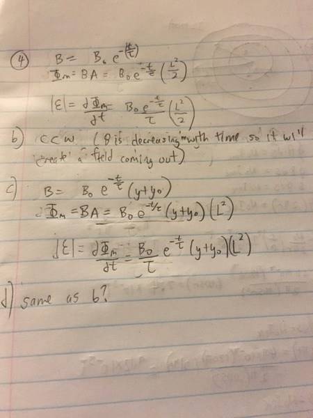

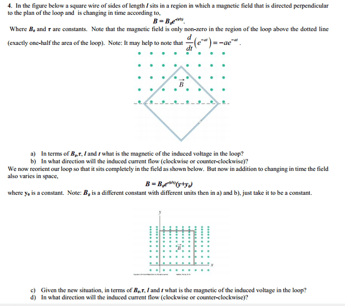

Hey everyone I have a physics e&m question: [/B]
http://blob:https%3A//www.physicsforums.com/aa779f37-be23-43d7-a888-d70263a3854b
I took the derivative to find the magnitude of the induced voltage. (do I need to add a constant c?)
I am having trouble with the direction of the current flow though... Do I use the right hand rule?

There might be a small gap in the lower right-hand part of the loop
Likes Simon Bridge
Well spotted - there may well be.
Sorry! Yeah I meant magnitude.
Okay so the derivative of magnetic flux is the induced voltage. I am having trouble calculating flux. Flux = BA cos (theta). How do I get the area...?
What shape is the area in question?
Ahh I forgot that they gave us the length of the square. I think I was able to get it.

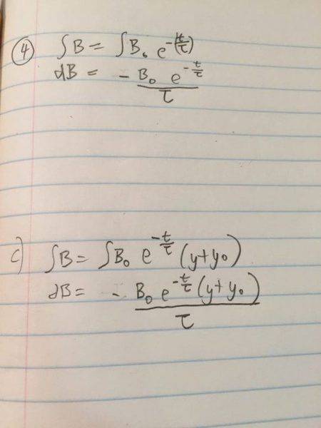

Does this look right?
in (c) and (d) the flux density is different in different parts of the square, how did you account for this?
(hint: the variable y should not be in your answer)
in (b) the question asks for the direction of the current
For b) I say it is counterclockwise. My reasoning is that the field is decreasing as time passes (e^(-t)). The field will want to come out and the way to do that is for the induced current to flow counterclockwise.
I am not clear on c). Doesn't the y variable account for the different flux values for different y values?
