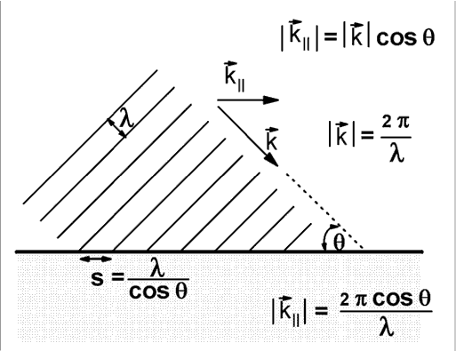

A light wave of wavelength 800 nm is directed in the x-y plane at 45o. For this propagating wave, 1) what is the magnitude of the k-vector?_________rads/cm
2) what is the magnitude of the k-vector?_________rads/cm
magnitude = 2(pie)/(wavelength)
I didnt understand the question. The magnitude is 2(pie)/wavelength. I get 78500 rad/cm which is pretty wrong as guess. Where would angle come into picture?
Ref: https://www.millersville.edu/physics/experiments/062/index.php
Shouldn't direction be like i + j + k ?
So will it be like:
|k|cos30 i + |k| sin30 j + 0 k ?

Says who ? I get the same. Perhaps they want to see 78540 ?
Yes, but ##\pi/4## instead of 30.
Picture has ##\vec k## pointing in ##-{\pi\over 4}## direction.

Shouldn't direction be unit vector like
The vector you mentioned divided by |k|?
jaus tail said:
What does 78540 signify. I mean so much radians / cm.
I get ##2\pi/##(8*10-5 cm) = 78539.82 rad/cm
If you want. One can also say that is the unit vector in that direction.
