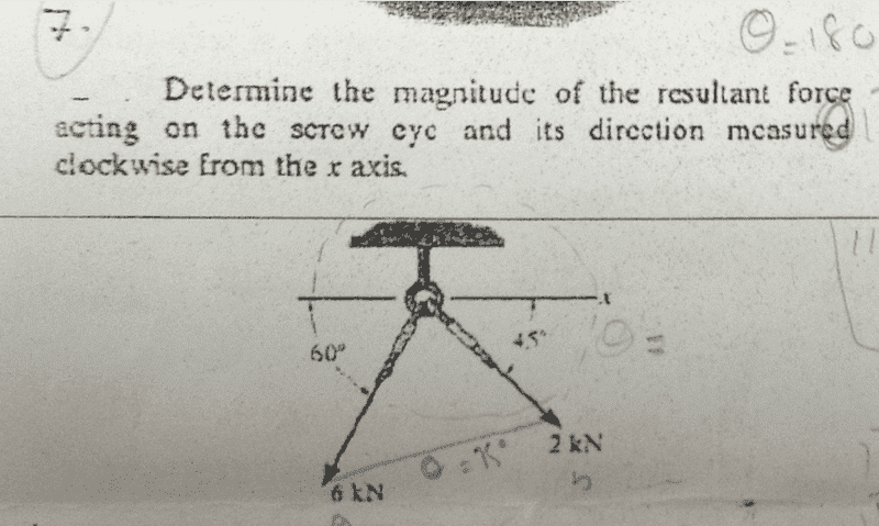

[itex]F = \sqrt{F_x^2 + F_y^2}[/itex]
[itex]tan\theta = F_y / F_x[/itex]
Page 1 : http://i49.tinypic.com/vfw74k.jpg
Page 2 : http://i50.tinypic.com/2qspamr.jpg
Page 3 : http://i49.tinypic.com/24zgl6x.jpg
is it correct?
I think you've got the directions wrong. The x-component of forces are in opposite directions, so you need to account for that.
You've calculated the y-component of the resultant correctly, but even there you haven't specified the downward direction which could cause you to lose marks sometimes.
Since, your calculation for x-components is wrong, the magnitude and direction of the resultant is also wrong...:smile:
the first two look okay the last page #3 you used vector length value so your tan angle is wrong.
A quick way to check your solution is to graph it and take measurements for the angle and length to see that your results agree.

Shouldn't Fx=-6000cos(60°)+2000cos(45°)?
Yes, I think you're right. I didn't notice that.
so after doing Fx=-6000cos(60°)+2000cos(45°)
resultant force is 6797.915 correct?
Yes. And what will be the angle made by that resultant with the positive x-axis??
[itex]tan\theta = f_y/F_x[/itex]
76.51(i didn't use minus sign in f_y)
180-76.51= 103.48
right?
180-76.51= 103.48
right?
Correct! :)
