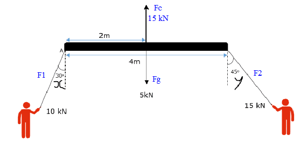

I need help as to how to find the magnitude and direction of the resultant force, and the equilibrant force.
Any and all help is greatly appreciate as I'm stressing myself out over it and I'm not sure what to do.
Thanks, Jamie.
First question respectively:
Second question repsectively:

I updated the first link to show the description which accompanied the diagram, and added another link showing the question related to the diagram. I tried working out the x and y components, and once I done that I didn't know what to do afterwards. I used pythagoras' theorem to try and find the magnitude but that was for one "triangle" I guess but I need to find the magnitude ect of the entire "tool" and to which I have had no luck whatsoever.
Show your calculations so far. For example, for each force on the diagram show your calculation for its x and y components.
What does one do with a set of forces in order to find the resultant (or net) force?

The two men are each applying a force, F1 = 10 kN and F2 = 15 kN. Gravity contributes Fg = 5 kN and the crane is providing an upward force of Fc = 15 kN. So that's four forces to break down into their components before you can sum them to yield your resultant. Make a list and fill out the components:
##F1_x = ~?##
##F1_y = ~?##
##F2_x = ~?##
##F2_y = ~?##
##Fg_x = ~?##
##Fg_y = ~?##
##Fc_x = ~?##
##Fc_y = ~?##
I do apologise, first time posting on this forum. Here's my attempt at calculating the components of each of the forces:
F1x = 4.33kN
F1y = 4.33kN
F2x = 7.49kN
F2y = 7.49kN
Fgx = 0kN
Fgy = -5kN
Fcx = 0kN
Fcy = 15kN
Not sure if last 2 forces are correct.

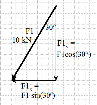

Okay, the last two forces are correct. But the first two are not!
Looking back at the images that you added to the first post it looks like you're applying trig twice for some reason. You extracted the components correctly and then took those values and multiplied them by sines and cosines again. That's not right.
You actually extracted the components of F1 and F2 in this image from your post:
You've used arrows instead of signs to indicate their directions, but the numerical values are fine. You can use these values (with appropriate signs) to update the force list.
Taking the force F1 as an example you can draw the force and its components:
and that's it for extracting the components of F1.
First off, I'd like to say thanks for the help thus far, only decent help I've recieved, and that's ironic that the first 2 are incorrect hahaha.
So I'm assuming that they should look something like this?
F1x = 5kN
F1y = 8.66kN
F2x = 10.6kN
F2y = 10.6kN
Fgx = 0kN
Fgy = -5kN
Fcx = 0kN
Fcy = 15kN

The digits are now correct, but you need to set the correct signs on the components. F1 is pointing down and to the left, putting it in the 3rd quadrant of the Cartesian plane. What signs should you give its components? F2 is pointing down and to the right, putting it in the 4th quadrant. What signs will its components have?
The next two forces are fine, having the right signs on the components:
Fgx = 0kN
Fgy = -5kN
Fcx = 0kN
Fcy = 15kN

Before calculating magnitudes you need to compose the resultant (or net) force. What do you know about finding the net force when several forces are acting?

I guess we need to add the negative signs in where suitable, since F1 is pointing down and to the left, both axis must be negative, and as for F2, only one axis is negative, in this case it is y so a negative sign must be added.
F1x = -5kN
F1y = -8.66kN
F2x = 10.6kN
F2y = -10.6kN
As for resulting force, do we add the acting forces together? I think I used the forumla
R = F1+F2+... or in our case, I think, R = F1x + F1y +...
I'm not sure if I add just the two forces e.g F1x and F2y or if I add both them and the 10kN we were originally told about, I believe I also get confused at this point :sorry:

The reason for breaking the forces into their components is so that you can add the vectors together. You add vectors by adding up their like-components. Sum up all the x-components to give you the x-component of the resultant force. Similarly, sum up all the y-components to give you the y-component of the resultant force. In the end you have the two components that make up the resultant.
Would it be like this for the x-components:
F1x = -5kN
F2x = 10.6kN
Fgx = 0kN
Fcx = 0kN
Rx = -5 + 10.6
Rx = 5.6kN
And for y-components:
F1y = -8.66kN
F2y = -10.6kN
Fgy = -5kN
Fcy = 15kN
Ry = -8.66 + -10.66 + -5 + 15
Ry = -9.32kN
Leaving us with Rx = 5.6kN and Ry = -9.32kN
I was convinced I had to do it all seperately, that's why I labeled one part 'x' and another part 'y' on the diagram :rolleyes:

Looks right.
I note that it asks for the magnitude and direction of the equilibrant force. Of course, to achieve equilibrium there must also be no net torque, so the line of application of the equilibrant force is also important. Strange that it does not ask for that. Is there perhaps another part to the question?
Yes, there were 4 questions in total, I thought I had done the first two but I had only partially done the 2nd one and I was seriously struggling with the 3rd and 4th questions. These are all the questions that came with the diagram:

To find the magnitude and direction of the resultant force.
Magnitude:
R = √Rx2 + Ry2
R = √
5.62 + 9.322 = 10.8kN
Direction:
θ = tan-1 Ry /Rx
θ = tan-1 9.32 / 5.6 = 59°
I'm near certain those calculations are correct.

Almost. Check the angle: What are the signs of the force components? Did you include them in the determination of the angle?
Oops, forgot the minus.
θ = tan-1 -9.32 / 5.6 = -59 which would be 360 - 59 = 301°?
Becoming, 10.8kN and 301°?

-59° is adequate. Usually angles are "normalized" to the range -180° ≤ θ ≤ 180° for presentation.
So now you have the resultant force in both component form and polar form (magnitude and angle). What's next?

Ah okay thanks, and I suppose I now need to find the magnitude and direction of the equilibrant force. I know that for an equilibrium to be made, it needs to have equal forces acting upon it but I'm not sure what steps to take, would the force just be 10.8kN and the angle 59° instead of -59°?
To counter the resultant force the equilibrant force must have the opposite direction to the resultant force. Just negating the angle won't do (think, for example, about small angles close to the x-axis). The angles should end being 180° apart...

Yeah, not sure why I decided to whack a minus in front of it and assume it 180° hahaha. Would it be 118° instead?

-59 + 180 = ?

121°.. I most definitely misclicked.. I added the two numbers together.
Okay!
Another approach: Your equilibrant force is the negative of the resultant force, so another way to find the equilibrant is to negate the components of the resultant. That is:
##F_{eq} = - F_{res}##
So what are the components of the equilibrant force?

Would they be..
Ex = -5.6kN and Ey = 9.32kN ?
Yes. And that's probably the most expedient way to get from the resultant to the equilibriant, since you'll be needing its components (at least one of them) to deal with the torque issue.

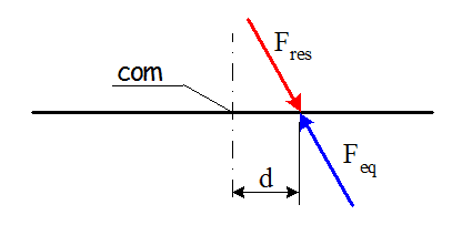

  • #31
Okay, I'm back, yes I know so soon but I brought answers with me nonetheless, I came here to check them with your great knowledge or if it happens to be, someone else's great knowledge. So where did we leave off.. ah yes, the moments. Question 'iv' asked, "Find the position of the resultant and equilibrant force by taking moments about point "A"". I manage to conjure some sort of answer for a force, only one though, couldn't get my head round (what a surprise) the other force. I got an answer for what I believe to be the postion of the 'resultant force', whether it's correct or not remains a mystery, I do hope by postion though it means in my case, 'm' for meters, I don't think it is Nm for this case but wouldn't surprise me if I were wrong.
These are the calculations that I done:
M = (-8.66x2)-(-10.6x4)-(10.8xd) = 0
25.08 - 10.8d = 0
d = 25.08 / 10.8
d = 2.32m
Update
Had a bit of a brain fart and thought that since the equilibrant force had to be in the opposite direction of the resultant force, would I just take 2.32 from 4 (4 being the whole length of the tool) and then that would give me the position of the equilibrant force? Honestly at this point I'm clinging onto anything that seems to be some sort of way of obtaining an answer, whether it's right or wrong.
  • #32
A good start, however...
It looks like you've used the y-components of F1 and F2 and the magnitude of the equilibrant force to write a moment equation. But there are a few problems here. First, they're not all the forces acting to produce a moment, and second, since the moment is to be taken about point A, all distances should be measured from that point. So the distance for first term will not be 2 meters, but zero meters (So F1 won't contribute to the moment about A since it passes through A). Third, you don't want to use the magnitudes of any of the forces involved, only their y-components. Only their y-components act perpendicularly to the tool to cause a torque.
Write your equation again using the y-components of all the forces acting.
  • #33
Okay thanks for the help again, I re-wrote the equation to try and fit what you said:
M = (-8.66x0)-(-10.6x4)-(-5x2)-(15x2)
= 22.4
Should I include F1 even though it has no effect on the moment? I removed it from the equation and done it again and got a different answer (-62.4) although I tried again with just a '0' first as that is what that single sum (-8.66x0) equals and I got 22.4 again.
  • #34
That looks okay (although you should put units on the result of the sum). You can include F1 or not so long as the distance for it is correct. It should not change the sum.
So that sum represents the moment about point A due to the existing forces. Can you now place the equilibrant force to cancel it out?
  • #35
Honestly, nope hahaha, do I divide it by the equilibrium magnitude? I don't have my notes with me at the moment so I can't remember what I wrote down :rolleyes:
