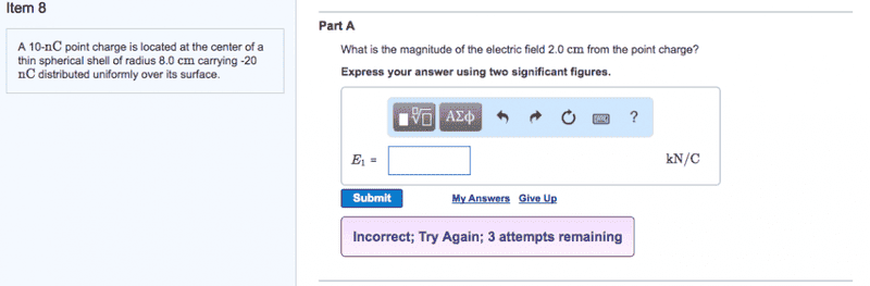

A 10-nC point charge is located at the center of a thin spherical shell of radius 8.0 cm carrying -20 nC distributed uniformly over its surface.
What is the magnitude of the electric field 2.0 cm from the point charge?
E = kq1q2/r^2
I used k = 8.99*10^9 and the q charge with a distance of 0.08cm-0.02cm to get E = (8.99*10^9 C)(10*10^-9)(-20*10^-9)/(0.08-0.02)^2 = 9*10^5 N/C or 900 kN/C which is wrong. How do I go about doing this problem?

Relevant equation is ##E=k{q\over r^2}##
Did you learn about Gauss's theorem ? Tells you you can ignore the shell at 8 cm: it doesn't contribute to the field at 2 cm.

OHHHH so then it should just be (8.99*10^9)(10*10^-9)/(0.02)^2 correct? And I still get confused on the uniform charge of sphere.
Correct if you add units.
What is the field inside a uniformly charged sphere (just from this sphere)?
0 correct?
Right.
