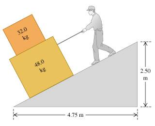

The problem is this
You are lowering two boxes, one on top of the other, down the ramp with length 4.75m and height 2.5m (The ramp has its highest point at the right. Even though this isn't relevant to the problem i wanted to include it to give the clearest picture of the situation considering i cannot post the figure) by pulling on a rope parallel to the surface of the ramp. Both boxes move together at a constant speed of 19.0cm/s . The coefficient of kinetic friction between the ramp and the lower box is 0.410, and the coefficient of static friction between the two boxes is 0.777.
The mass of the upper box is 32kg and the mass of the lower box is 48kg
Attempt at a solution:
I was successful in finding the force needed to accomplish this task is 80.7N
The trouble area is in the second part of the question where they ask "What is the magnitude of the friction force on the upper box?"
So using trig i can see that the angle of elevation is around 27.759degrees
Thus the normal force acting on the upper box would be the force of the weight of the box multiplied by the cosine of the angle of elevation giving me the perpendicular-to-the-plane component which = 32kg(9.8m/s^2)COS27.759
The coefficient of static friction between the two boxes is .777 so the magnitude of friction acting on the upper box should be .777(32kg(9.8m/s^2)COS27.759) = 215.62N
This answer is wrong and I have become incredibly frustrated as everywhere I look it seems I'm doing this correctly, so i must be missing something. Once again, any help is greatly appreciated.

Here is the image of the problem. This is driving me insane i cannot see what I'm missing here.
Ok, I understand the set up now. The pull on the rope is just sufficient to stop the boxes accelerating down the slope. But whether the pull is downslope or upslope makes no difference to the question about frictional force on the upper box.

Yes, that's its value, but in terms of combinations of other forces what is it equal to?
Hey so 146 N Is the answer which makes sense considering that this force is required to keep the box from moving, but why Is this not the value of my original calculations? Shouldn't the answer be the same whether evaluating the force of friction derived from the normal force and from the coefficient of friction or from finding it by seeing what force is needed to keep the box from moving?
I thought I explained this. The coefficient of static friction only tells you the maximum ratio between the frictional force and the normal force. If the actual frictional force is less than ##\mu_k N## then sliding does not occur. You were asked for the actual force, not the maximum force.
Ahhhhhh it all make sense now. Sorry I was so dense previously. Thank you so much for your help this is an important concept I would have missed otherwise!
