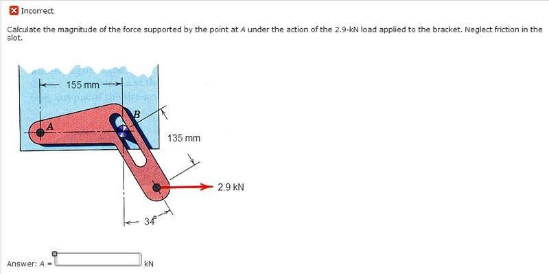

Calculate the magnitude of the force supported by the point at A under the action of the 2.9-kN load applied to the bracket. Neglect friction in the slot.
ƩMA=0
ƩFy=0
ƩFx=0
I started by finding the moment around A so that I could solve for the vertical force at B:
ΔyAC=(135)sin(34)
MA=0=(2.9)(75.459)-FBy(155)
FBy=-1.41
Then I found FBX using trig functions and the angle between the vertical axis and FB:
(-1.41)tan(56)=-2.09
Then I summed all the forces to find the components of the force at point A:
ƩFy=0=-1.41+FAy
FAy=1.41Kn
ƩFx=0=-2.09+2.99+FAx
FAx=0.9Kn
Then I found FA using the Pythagorean theorem
FA=√(0.92+1.412)=1.672Kn
This was wrong, am I missing a force/forces somewhere, or are my calculations incorrect?
Thanks for any help!

Given what you're tying to do, are you sure you want to use sin(34) for that?
Likes 1 person
I changed my calculation to 135*sin(34) and re-did all of my calculations to get a final answer of FA=2.09Kn, but that's still wrong.
What I meant to express is that you are using the sine function. Are you sure that the sine function is the appropriate function here? Maybe a cosine would be better? :wink:
Gah! Typos are an enemy today. I did use 135*cos(34) and ended up with FA=2.09Kn.
Okay, 2.09 kN is the y-component of the force at point A. But there's still the x-component to figure out.
Likes 1 person
The x-component of the force at A = 3.10-2.9 = 0.2
After Pythagorean theorem the force at A comes to 2.099Kn which the system says is incorrect.
I figured it out, I just had to round to 2.10.
Thanks collinsmark!
