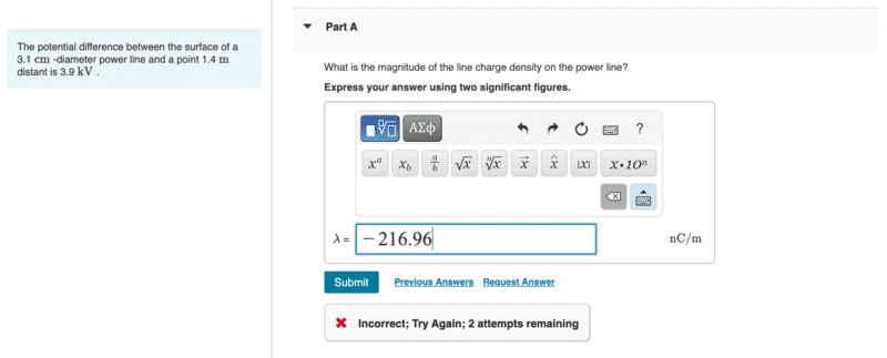

The potential difference between the surface of a 3.1 cm - diameter power line and a point 1.4 m distance is 3.9 kV.
Delta V = - E Delta r
Phi = Integral (E A) = qenc/epsilon naught
Okay so I am a little confused as to where I made a mistake. I couldn't figure out how to program Latex into this website but I attached a file with the work I did and an explanation of my thought process along the way.
  • Physics Homework Help.pdf
See the "LaTeX Guide" link at the lower left of the Edit window. :smile:
Likes MatinSAR and frankifur
Hello @frankifur ,
:welcome: ##\qquad## !​
You want to use something better than ##\Delta V = -E\,r ##. Closer to ## dV = -E\, dr ##.
I figured it out, thanks for the help and I appreciate how welcoming you all have been!
