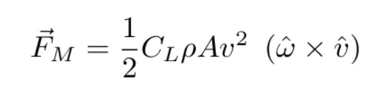

In this article:
http://spiff.rit.edu/richmond/baseball/traj/traj.html#spin
The force is given by:
I found the same formula in another article:
https://www.researchgate.net/publication/328816286_Model_trajectories_for_a_spinning_tennis_ball_I_The_service_stroke
Guess what, now it is different:
Can anybody clarify what is the correct dimensional analysis of this equation?
Thanks.

I found on another book FL does not depend explicitly on w, it does just because CL is a function of w.
I hope this helps others.

I just recently ran into the same problem as you, and I've been testing the different formulas I've been finding on a shot simulator I'm developing, (for fun purposes) and the formula I found was working. was this one.
Fm = ½ * CL * ρ * A * v2 (ω x v)
where ω and v are the unit vectors.
The think here is as somebody else mentioned CL is in function of the spin magnitude.
What I did to find that function I found a code repository that has lift and drag coefficients (constant) for each of the different clubs a golfer can use, https://github.com/x00126177/GolfBall-Simulator
I then went and looked up the average ball speeds for those clubs for Tour players https://blog.trackmangolf.com/trackman-average-tour-stats/
made a plot in spreadsheets with the data and used a polynomial regression to fit the drag, and lift coefficients to functions of velocity and spin respectively.
here are the functions I found for the drag and lift coefficients from the data I gathered.
CD(v) = 0.0606 + 0.0129v - 2.57E-04v2 + 1.49E-06v3
CD(ω) = 0.176 - 4x10-4ω + 1.36x10-6ω2 - 1.58x10-9ω3 + 6.41x10-13ω4
The results I get are close to what Trackman calculates, but are a bit longer. my guess at the moment is that I'm missing the wind force calculation adjustment.
