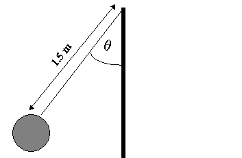

A 0.5 kg mass is attached to a string that is 20 cm tall and anchored to a pole. There is an angle between the string and the pole.
1) What is the force of gravity on the mass in terms of the angle?
2) If the mass is pulled slightly to an angle of 5 degrees and if sin(theta) is congruent to theta, find an equation and its solution that best fits the case when at time = 0 the mass is held at 5 degrees. (If you are stuck, please consider the following two questions: a) What is the moment of inertia of the mass on the string in terms of mass and string length L? b) What is the expression for the angular acceleration I(omega) in terms of mass and string length L and d(theta)/dt when one notes that d(theta)/dt = omega?)
3) Will the mass oscillate if the mass is released after being pulled to 5 degrees?
4) If it oscillates, what is the angular frequency if the mass is 0.2 kg?
5) If it oscillates, does doubling the mass change the frequency, and if so how?
6) If it oscillates, does doubling the length of the string change the frequency, and if so how?

Hi, thank you for assisting me!
As for the diagram, the pole, according to my teacher, is upright and the ball is pulled to the right at a certain degree. So it should be swinging left and right in simple harmonic motion. Kind of like in the following picture, minus the measurements.

brinstar said:
Oh gosh, now I'm confused. I tried asking my teacher for more help, and she said the answer to 1 was mgsin(theta). I am very unsure of myself now.
I'm afraid your teacher asked the question wrongly, if that is the answer she wants.
The force of gravity is always going to be mg here. Your teacher should have asked for the net force. Can you see how to get her answer with that interpretation?
(And yes, that equals sign with a tilde above it means is approximately equal to.)
I'm with haruspex here. I'd also ask what stops the ball from hitting the pole, but I am cheeky that way. ;)
You can see haruspex is correct if you draw a free body diagram... gravity mg points down and tension T points off to the right at angle ##\theta## to the vertical. (This is like those problems you've probably seen where something slides down a slope, only you get tension instead of a normal force.)
You are going to want something like ##\tau = I\alpha## ... take care to distinguish between the oscillator angular frequency and the instantanious angular velocity of the mass.
