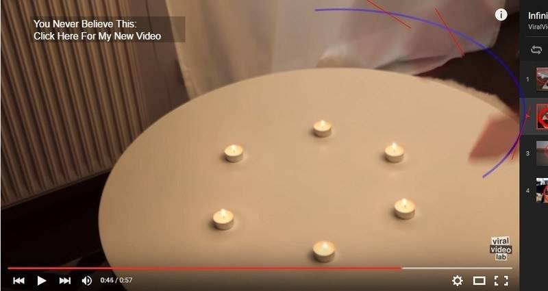

EDIT: Here's another from the same folks <link to video deleted>
:rolleyes:
That one look even more faked. :)
It behaves like it's attached to a string.
Totally.
Between 00:37 and 00:47 it's not even pointing in the direction it's moving. Just as it would if it were suspended on a string.
Busted.
