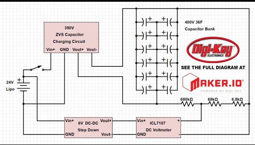

Step downs are common, but seems step ups are rare?
For one of my scientific projects, I want to charge a couple of 450V capacitors in parallel, which I get the power from household electricity, because a lot of lithium polymer batteries can be expensive and take up a lot of space.
The problem is, the power supply gives a 250V AC, and and I need 450V, or at least around 400 volts of DC. A common AC-DC transformer I can get at a electronic market turns the AC power to a 12V or 24V DC, and that’s pretty useless on its own. The other way is use 4 diodes to ensure the electricity goes one-way, so I can make DC, this method does not change voltage, therefore I get 250 volts, which is still not enough...
Is there a way I can get the high DC voltage I want? I heard Tesla car batteries are at 400 volts and the car can charge from household electricity. But I have no wielding devices and no professional skills in electric engineering. Can I still do it?

Not safely at least. Tampering with power from the electricity grid is a bad idea, trying to transform their voltages to higher values is a really bad (and potentially lethal) idea.
Why do you want to charge 450 V capacitors? There might be a better, safe option.

I’m hoping for the better and safer option, I don’t know how to charge them.
I’m using high voltage capacitors for a linear electromagnetic launcher (a more scientific name) , that uses Ampere force to launch stuff, as current goes through the projectile, and the force exerted depends on the current. So I need high voltage capacitors for rapid discharging so the launch will be more successful.
By the way, I find this circuit on the internet, which outputs 390V maybe? It requires 24V DC input, which I certainly can do. But it seems a bit complicated and requires lots and accurate wielding?

Well, that's two reasons to shut down this thread. You don't have experience with high voltages (and moderately high power), and you are still trying to build a rail gun. Please focus on safer projects while you build your skillset.
