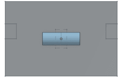

Hi all,
want to realize a system for a PCB which holds a solenoid coil moving in a vertical axis long about 600 mm. The coil must get electric contact only in some predefined positions so that, for a given quote, the coil connects to a different LC circuit for having different resonant frequency (infact, the resonance frequency depends from the height).
One problem is the space available: the PCB is 30 mm, but the space where it must move along the vertical is within 40 mm. Everything (PCB, contacts or/and cables) must fit in 40 mm
I though to a sort of creeping contacts but it looks impracticable with my knowledge.
Do you have any suggestion for that?

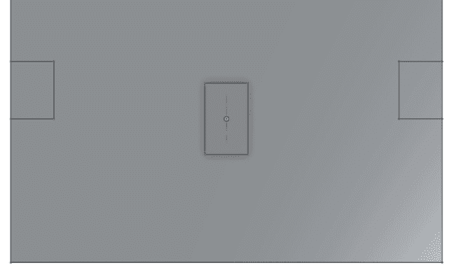

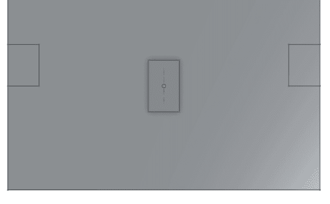

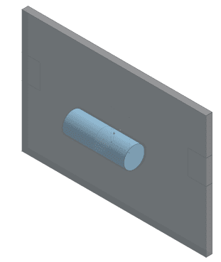

This is a view of the chip supporting the coil, dimensions about 30 x 20 mm.
This is the rear view of the CHIP where a Hall sensor is also visible
The rectalgular boxes in both sides are for making the solenoid coil in contact with differernt RF circuit filters.
Is it enough for explaning the project?
I am sorry but I am not a cad designer... I am old and I have more confidence with paper and pen.
Thank you
Mx
not really
so are you able to draw it, take a photo or so and upload the photos. Do you know how to do that ?

Thank you for your questions, I will try to be as more detailed as possible.
More details on microcoil here https://en.m.wikipedia.org/wiki/Microcoil
The application is for a long-term use, it is a device for reading RF signals from a chemical liquid sample moved into a magnetic field at fixed values.
The entities of currents is negligible in the sens that this class of application is quite similar to signals in MRI/NMR, where voltages amplitudes are in the range of nano/microvolt. The main purpose is to establish an electric contact for the solenoid in a given position where the magnetic field is known (that's why a Hall Sensor is present in other side of the PCB).
Let say 3 - 5 vertical positions (so 3 - 5 different resonant RLC circuits to be connected to the solenoid) are enough.
Could you use IR light to send data to the moving coil or do you also have to send power?
No, the signal pathway must be an RLC circuit as for an antenna.
Could you put a battery or super capacitor next to the coil that moves with it? Charge the battery when machine isn't being used?
No, the movement must be realized and contained inside the cylinder shield which is inserted in the magnet. Length and diameter are also fixed.
