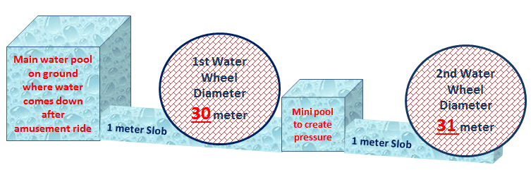

A.T., you gave good idea of Hydraulic ram pump and running wheel with "flowing water/river" and I am thinking to use both as combination.
The first priority is to "rotate water wheel" with "flowing water". Now the question is how much water required to rotate such wheel? I mean following:
1. How much water flow required
2. Above water flow can rotate how big wheel
3. How much water can be lifted in one round
I think this is good idea, I created one diagram of my idea regarding flowing water.
Will this work i.e. we can create slob to create pressure in water flow so wheel may be rotated but the question is how to measure force of flowing water?
How to measure force of flowing water or kinetic energy or potential energy of flowing water?
Any idea on this?
Shaks
The pressure is expressed in the height it fell. The energy is pressure times flow rate. So what exactly are the requirements?
I really don't think you are recognizing just how difficult and expensive it will be to build a 30m water wheel.
Looking at the diagram, it seems that your scheme is to use water-powered water wheels. The first wheel uses a 1 meter downward slope to power a wheel that lifts water by 30 meters (net 29 meters). Energy conservation requires that the fraction of water lifted by this wheel can be no more than 1/30 of the total flow.
The next wheel uses another 1 meter downward slope to lift the water by 31 meters (net 29 meters after the two drops) Energy conservation requires that the fraction of water lifted by this wheel can be no more than 1/31 of its input flow.
If you wanted to get (let's say) 99% of the water to be lifted by 29 meters you would need to allow 1% of the water to fall through a total of about 2900 water wheels ending with one that is roughly 2.9 kilometers in diameter.
Then you'd still need to somehow get enough water to the top of your 2.9 kilometer mountain (or up out of the bottom of your 2.9 kilometer deep wheel well) to make up for that 1% leak rate. The efficiency losses in such a scheme would be enormous.
Oh, requirements were in the first post: at 50% efficiency, that's about 90 kW. Its a pretty high flow rate and lift.
You mean that one wheel can lift around 1% of total water flowed under the wheel? Can you copy formula here?

Your question is not answerable in this forum. You are not posing a problem in physics; you are posing a problem in engineering and economy. We can discuss the principles water wheels and pumps; we could even figure out estimates of their efficiency. But a "minimum cost" design is a totally different beast. For example, from a "minimum cost" standpoint your idea that "these wheels will cost one time" is false. They will have wear and tear; they will need maintenance. It is one thing to maintain a compact device, even high tech, and quite another to maintain a huge structure.
From the engineering/economic point of view, your question is invalid to begin with. Before you literally go inventing a wheel, you should get a firm grasp of the contemporary technology used to lift water and what costs its use incurs. Knowing the cost structure, you can pose valid questions: how can I optimize the costs? Where could I save most?
