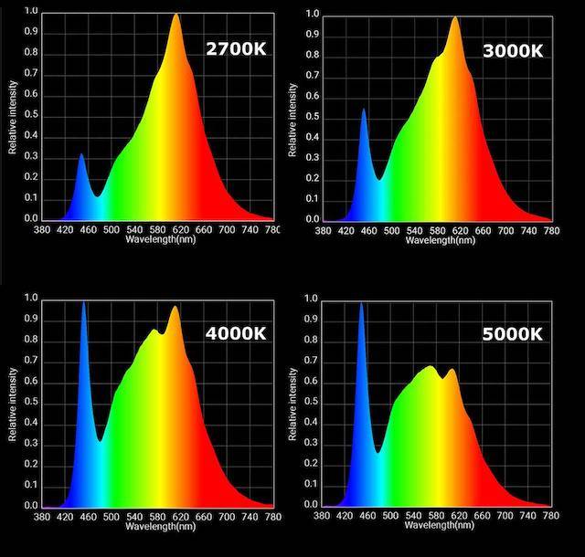

renault said:
1) if it is possible to simply block out the lower wavelengths by 'just wear glasses at night' then why don't manufacturers envelop their bulbs with the same glass and stop the problem at source.?
Because then they wouldn't have white lights. They would have orangish lights.
renault said:
2) If I understand correctly, manufacturers change the ratio of the elements which form the semiconductor in order that it produces light of a certain colour. So they can produce 'white' light. I guess then the question is how narrow a bandwidth of light can they achieve and can that be sufficient enough to eliminate all the lower wavelengths.
You can't eliminate blue light if you want to achieve white light. You're going to need at least some.
Likes PhDeezNutz and Motore

renault said:
Your second two points say that it is not possible to have white light without blue light. Just to be clear (I am learning a lot here !) would that be the same as saying that it is not possible to achieve white light from a source whose intensity is from around 500nm. to 700nm.?
That's exactly right.

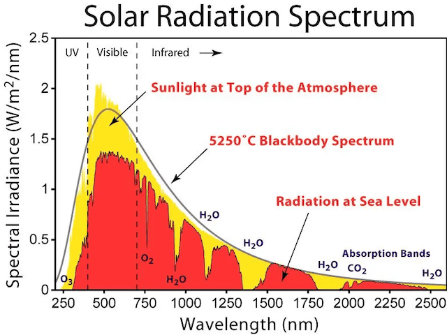

Finally, is there a direct correlation between colour temperature and wavelength. I can't find a graph showing that there is.
No, but there is one between color temperature and color. The reason there isn't one between color temp and wavelength is that, on the whole, many different combinations of wavelengths can generate the same color. This is why the red, green, and blue pixels on your computer of phone screen can generate yellow, orange, and other non RGB colors.
Note that color temperature is based on a black body, which is a hypothetical perfectly emissive object that emits a predictable spectrum at specific temperature. For example, a 6,000 K black body looks white because its spectrum closely matches that of the Sun, which is the light source our eyes evolved to use. A 4,000 K black body looks slightly yellowish, and as we lower the temperature the color of the object becomes more orange, then red, then disappears completely once the temperature is too low to emit enough visible light to even see.
Also note that the descriptions used in describing lights, such as "natural white", "cool white", "daylight white", and the like are nothing more than marketing words and have little to do with the actual color of the light.
If you'd like to see the spectrum emitted by a black body at some temperature, you can use the following link to make your own graphs: https://www.spectralcalc.com/blackbody_calculator/blackbody.php
Likes PeterDonis and pinball1970
