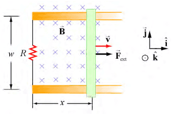

Next consider that the conducting bar slides along two frictionless conducting rails that are at a distance ##w## apart and connected together by a resistor with resistance ##R##.
Then the emf is defined
$$\mathcal{E}=\oint \frac{\vec{F}_B}{q}\cdot d\vec{s}=\oint_{loop} (\vec{v}\times\vec{B})\cdot d\vec{s}$$
$$=\int_{bar}vB\hat{j}\cdot (dy\hat{j})=Bwv$$
Note that in this case the induced current can be explained by the magnetic force on the charges in the conductor due to the relative motion between the loop and the magnetic field.
The emf is the work done by the magnetic force per unit charge.
This last statement is a bit confusing to me since I was under the impression that magnetic fields don't do work.

zenterix said:
Now, there is no loop here, so I am not sure what magnetic flux means here.
You cannot have magnetic flux unless you define a surface over which you integrate to find the flux but once you define a surface you have a loop enclosing it. Perhaps you are missing that what you have been working with is Faraday's law in integral form. Faraday's in differential form is $$\mathbf {\nabla}\times \mathbf E=-\frac{\partial \mathbf B}{\partial t}.$$ It has point functions on either side. To get the integral form, first you define some area ##S##, orient the area so that the local normal on an area element ##dA## is ##\mathbf {\hat n}## and dot both sides with ##\mathbf{\hat n}~dA##,$$(\mathbf {\nabla}\times \mathbf E)\cdot \mathbf{\hat n}~dA=-\frac{\partial }{\partial t}(\mathbf B\cdot \mathbf{\hat n})~dA.$$Then you integrate both sides over the chosen surface ##S## ,$$\int_S(\mathbf {\nabla}\times \mathbf E)\cdot \mathbf{\hat n}~dA=-\frac{\partial }{\partial t}\int_S(\mathbf B\cdot \mathbf{\hat n})~dA.$$Finally, you apply Stokes' theorem to convert the surface integral on the LHS to a line integral over the loop ##C## enclosing ##S## to cast Faraday's law into integral form $$\oint_C \mathbf E\cdot d\mathbf{\ell}=-\frac{\partial }{\partial t}\int_S(\mathbf B\cdot \mathbf{\hat n})~dA.$$In its differential form, Faraday's law says that the explicit time rate of change of the magnetic field at a given point is the source of circulating electric field lines about that point. These lines are there regardless. If you place charges in that region of space, they get pushed around by the electric field lines. If you don't place charges there they don't.
That impression is incorrect. It is uniform magnetic fields that don't do work on moving charges. Electric motors do quite a bit of work for humanity every day. Look them up. There are numerous animations of how they work on the web.
