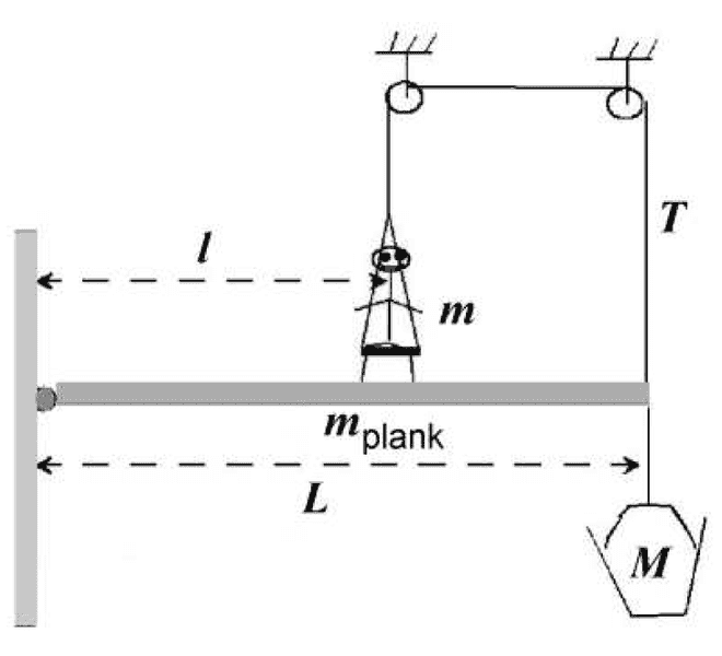

In summary, a professor (m=75kg) is seated on a light harness connected to a rope and pulley system, with his feet touching a uniform plank (mplank=15kg) supported by a hinge at the wall. A bucket (M) is suspended from the right end of the plank. The task is to label all the forces on a free body diagram (FBD) and find the tension (T) if M=0. The FBD should include the forces of the professor's weight, the normal force, the tension in the rope, and the weight of the bucket. The equations for the torques about the hinge end of the plank should also be considered. The tension (T) will be constant

A professor (m= 75 kg )is seated on a light harness connected to a rope and pulley system. The professor's feet touch a uniform plank (mplank = 15kg) which is supported by a hinge at the wall. A bucket (M) is suspended from the right end of the plank.
m = 75kg
mplank = 15kg
l = 2m
L = 4.9m
Find: Label all the forces on a FBD
Find: T if M=0
[/B]
ΣMhing = 0
I took the moment about the hinge and looked at the man by himself. I think I'm drawing my FBD diagram incorrectly.

From your drawing it's clear that the rope is attached to the end of the plank. That should be in the problem statement !
If prof is sitting in the harness, I expect one more force in his FBD. Otherwise I think you have most of it covered. Fry is the only horizontal force I see, so it may well be 0...

J Hann said:
Also, you know that T is constant throughout the length of the rope.
Well, not quite. Since the rope is attached to the end of the plank, the section of rope below the plank will be at a different tension.

Also, that M=0 condition is only for the final part of the question.
##T## is the tension in the section of rope above the plank. The section below will have a tension equal to ##Mg## which will generally be different than ##T##, particularly if ##M=0##.

Since the rope is connected to the man, why isn't T=(mass of man)*g
Part of his weight is taken by the harness !
I'm still having trouble understanding this question. Can someone draw a FBD ? Is Normal Force suppose to be on the FBD?

No, that's why it could have been mg. The reason that T is not mg is that not all of the weight is taken by the harness.
An FBD relates to a single rigid body. There are two appropriate FBDs here, one for the man and one for the plank.
Your diagram depicted both, which is ok except that where those two bodies interact you need to show the equal and opposite forces between them.
